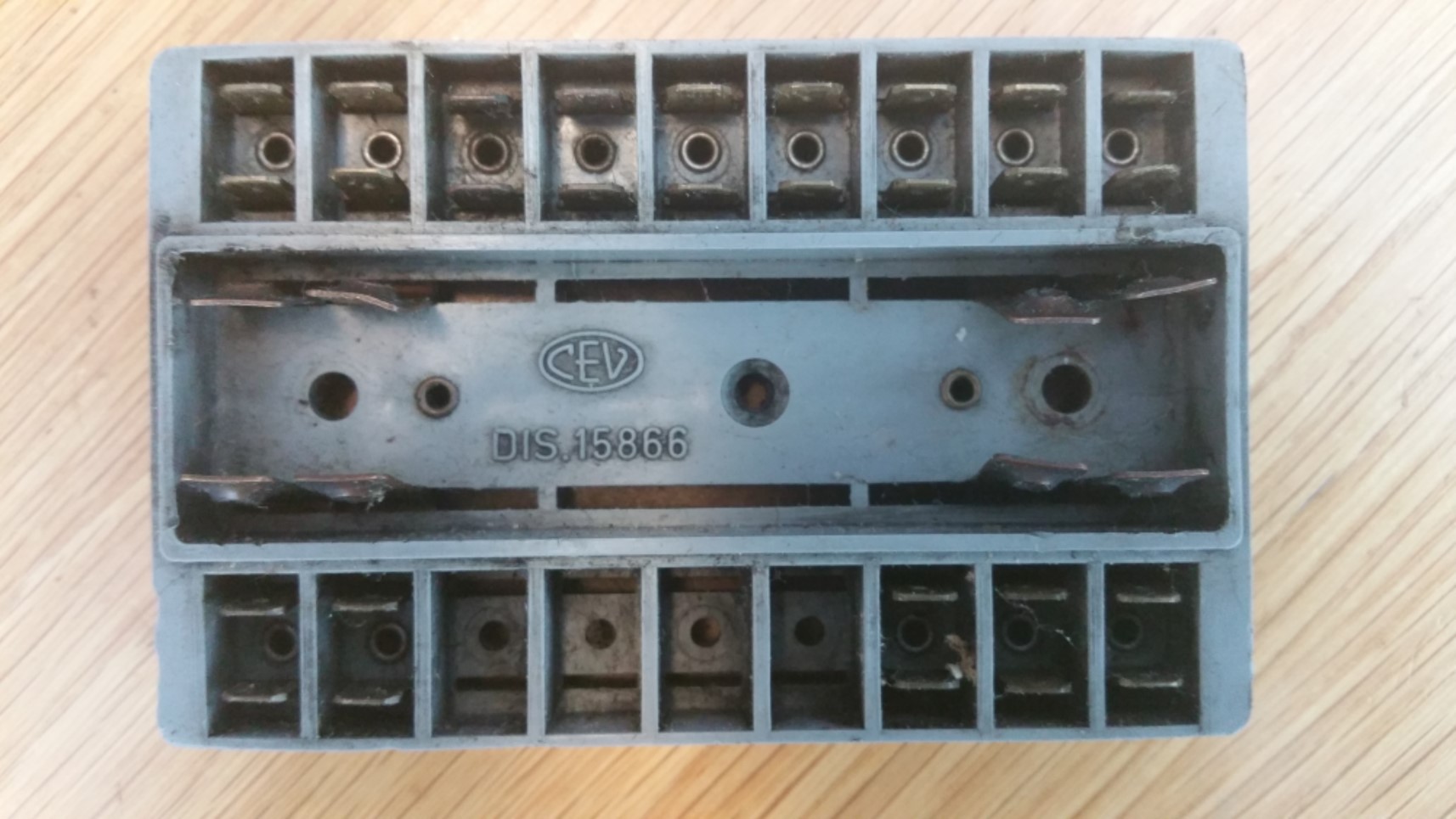

Here is a fuse board taken from a 1978 sport(CEVXXXT) which intermittent fault, its not so obvious, there is no cracking.
At the top left fuse , I can move the fuse holder left to right, this should not happen!
Closer inspection shows that the rivet in the middle of the two fast-on connectors
is loose, its sunken into the plastic. The plastic has melted at some point and made the rivet loose.
So please check that the fuse holders cannot be moved side to side.
It may be possible to re-rivet or rectify with a screw and nut after drilling out the rivet, or bridge with an inline fuse.
Any used ones are likely to be poor condition. There are also variants of the fuse board depending on model
with either the 5 pole or 6 pole main switch.
If the fuseboard is unservicable then perhaps better to use something that can take standard blade fuses
and a multi-pole connector block, try vehicle wiring products I used one of these on my 350
http://www.vehicle-wiring-products.eu/p ... e-fuse-box
