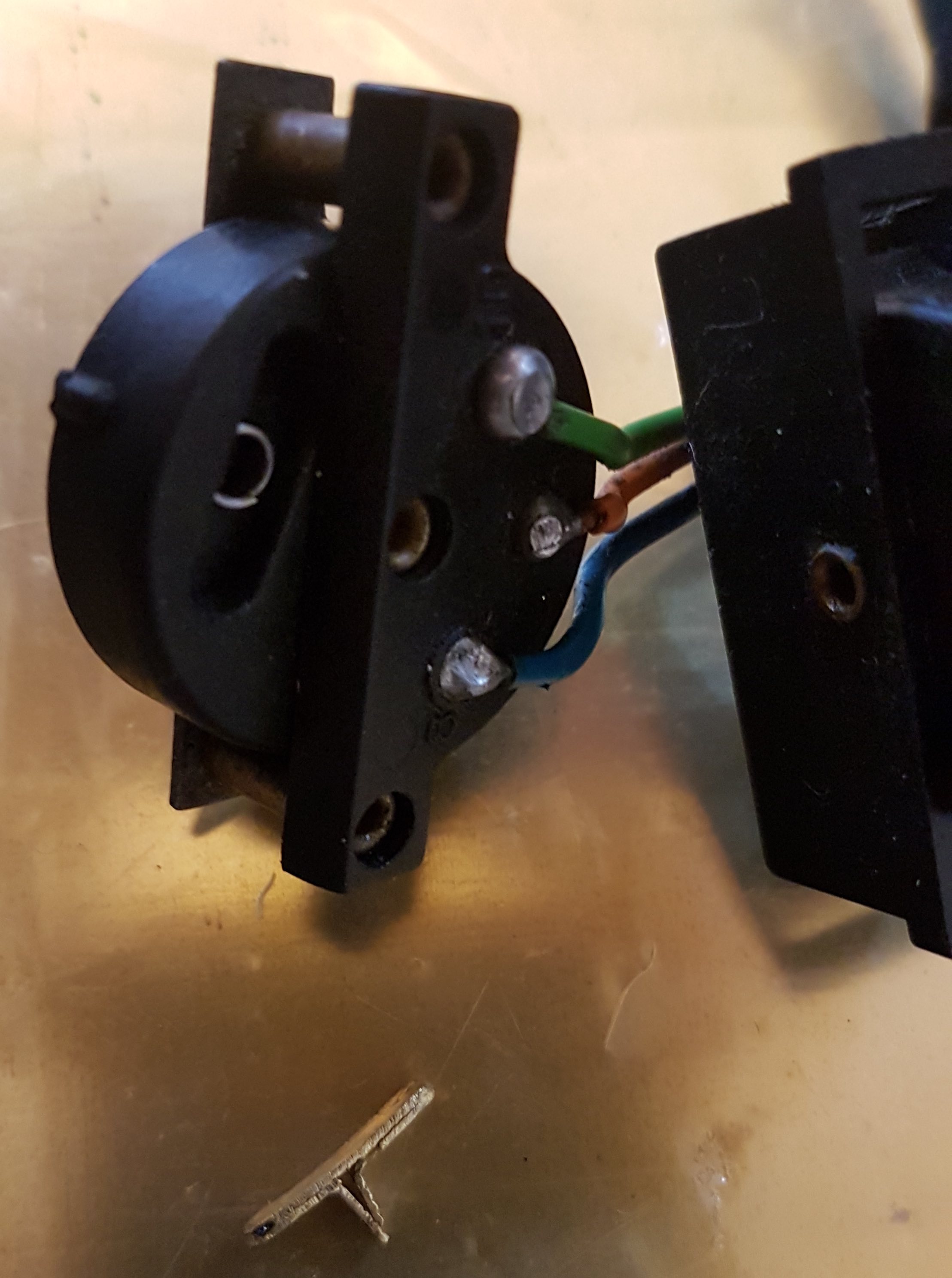

I bought a Kanguro where the indicator switch was missing the metal contact. I made a new one out of thin brass sheet I bought decades ago, probably around 0.25mm thickness by cutting a strip of 30mm x 4mm and folding it to suit. The fold points are 3mm, 6mm, 12mm, 6mm, 3mm - it's symmetrical. The 3mm need to be made narrower so they fit into the spring, I trimmed their width to roughly 3mm. Once I folded it (see photo) I also used a handfile to shape the ends so it fits tightly into the recess in the switch. I first made a prototype in cereal packet cardboard, as I learned from Blue Peter on TV in the 1970's. I still accidentally destroyed the first iteration of the brass strip.
There was a bit of fiddling and fettling to make sure the ends didn't catch against the contacts when the switch is operated. For those of you who get that far in the process I expect you'll work out what to do. Time taken, a couple of hours including thinking of ways to solve the problem and do the fettling. Cost, less than £1/$1/1€ brass sheet is still for sale in 2021 I discovered.
CEV206 Indicator switch and homebrew contact
