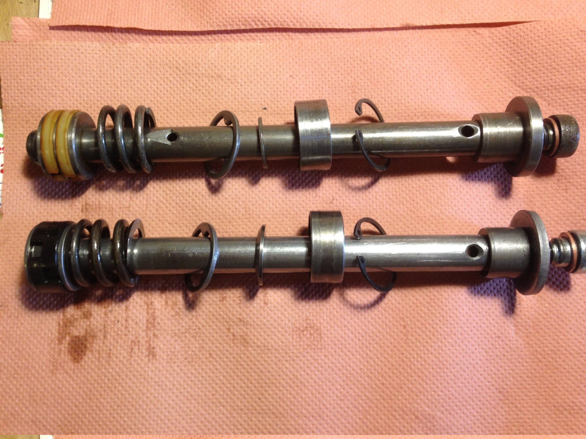

I finally got round to trying the mod as suggested by Paul back in May. I had an old pair of dampers which I have modified as per the instructions, so finally dismantled the K2 forks. What I found was a different set-up in the K2.
Modified 'old' damper top, 'new' K2 damper bottom. Differences are drilling diameters at the bottom (5mm cf 4.5mm), no drilling at the top on the K2 units, more robust plastic rings on the K2 units, better finish to the top of the K2 dampers and the fixing bolt of the K2 dampers is a smaller diameter, though shouldered to the same diameter as the older versions.
Anway, I've fitted the modded ones to see if there is any improvement in the harshness I experienced. Reassembly tomorrow and then see how they are.
