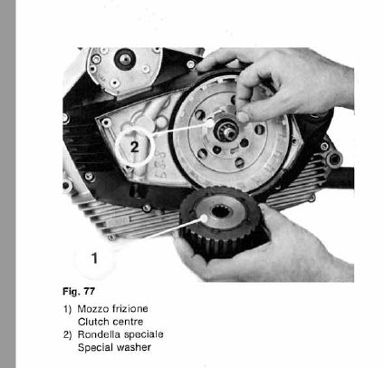

The clutch outer basket relative to inner centre end float should be between 0.02 and 0.08 mm , that is just perceptible float.
If there is a brushing sound as the clutch centre is rotated its OK but there should never be a knocking scraping or grinding
If there is excessive end float or binding at any point i suspect the special washer(bush) behind the clutch centre is failed.
Please say the age or engine number of the machine because there are three different types of special washer.
The clutch centre washer was on very early bikes made of steel but later replaced with bronze and finally with specially treated nylon
See picture:
Clutch special washer

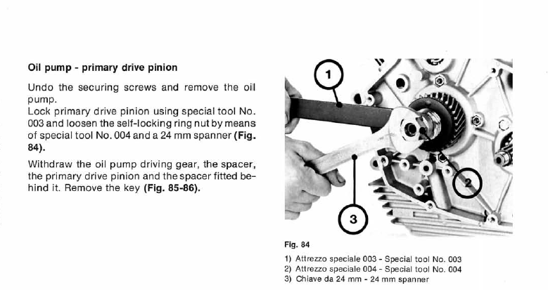

Thought's of this nut coming loose keep long time morini riders awake at night, because the oil pump gear may slip on the shaft, and oil pressure is lost.
Some cannot stand it anymore and take the cover off to check :D
If your's has the ring nut with a yellow nylon insert then you need two special tools. Earlier 350s it was just a regular nut so only the holding tool is needed.
Many would replace the older plain nuts as a matter of course. If the nut looks in bad condition like its been beaten round with a chisel/screwdriver etc I would replace it.
Check the oil pumps gear has some backlash and adjust the fitting of the screws if it doesn't.
All these points are in the workshop manual in any case.
Torque 5.0 mKg
Primary Drive pinion
