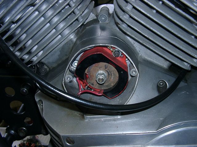

Thank you that's great. How about the small seal behind the ignition/power dynamo?
Posts: 1559
Re: Oil Seals
The Morini parts list shows not just the part number but also dimensions for most oil seals so for that end of the cam:
Part 23.0.11 SMIM 13.265 = 13x26x5
You don't really have to take the whole side cover off to change the clutch oil seals on a 350 though (unlike a 500) so no need to disturb that one unless it's also leaking.
