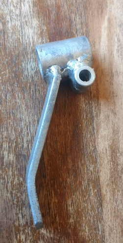

So I'm converting to rearsets and right hand shifting. My actuating arm at the gearbox is longer and goes to the inside between the engine and frame where the old mechanism links to it.
I need it to be shorter and directly below the shift shaft. Is there any chance anyone, ideally US based, might have one of these? I would rather buy than modify my existing lever arm. Attaching a picture of my arm...

If it helps, the splines are the same as a Guzzi shift shaft. I was using the shift lever from an Ambassador to operate the shift mechanism of the Morini 3 1/2 Sport engine while I was rebuilding it.

2 x rose joints and a 6mm rod of the length you want, threaded both ends?

That does help. I was trying not to modify the original linkage in case someone needs these parts. I'll hit my motorcycle wrecking yard today. Thanks.
