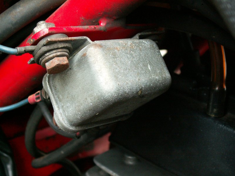

Hi all, I have a 1982 350 sport k1 that I am restoring. I am at the stage of sorting out the wiring/electrics and have a few questions. 1. There is a diode in the line of the green wire from the ignition key switch to the fuse box. What is the purpose of the diode and are they still available? 2. My instrument lights are oil, turn, hi beam and lights. Should there not be a neutral light? 3. Are the instruments lights still available? 4. Can someone send me a picture of how the start solenoid is mounted. My solenoid has one bolt hole. It may not be the original item, not really sure. There is a bracket on the frame with 2 holes, is it inner or outer hole? 5. Is there a wiring diagram for the K1? I have the manual from NLM and the wiring diagram is for a 350 but definitely not a K1. Any help would be very much appreciated as I would like to get it as close as original as possible.

I have a K1 Sport of the same year. Mine does not have the diode but Ming has already explained that. My instrument lights are the same as yours and there is no neutral switch (so no light). My solenoid has 2 bolt holes and so uses both in the bracket (picture attached). I have never come across a wiring diagram specific to the K1, but quite a lot is common to the standard diagram. If there are any specific points I can check my bike and let you know.
