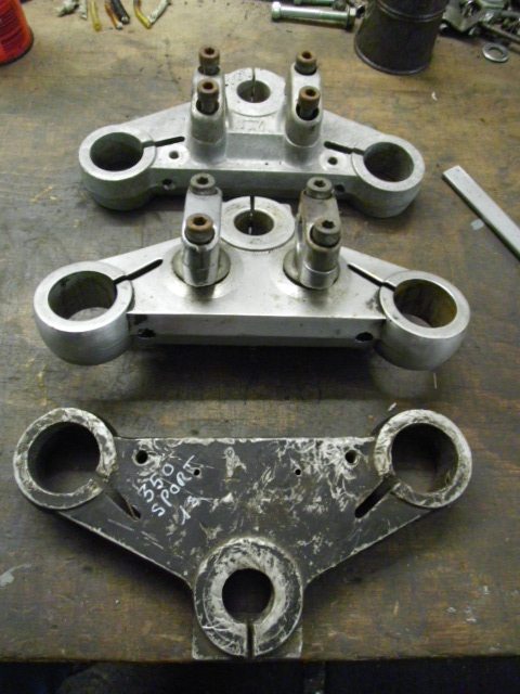

The three top yokes I know. I´m not sure if the ones with the rubber mounts are Paioli, but I don´t think so.
Yours surely was used with clip ons like a sport. I´ll have a look wether I´ve got a pair of that mountings, but there will be only a very little chance.
