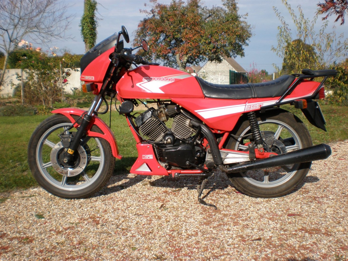

I've recently taken delivery of a 1986 K2. Still assessing it, looking OK so far, though the oil was black and seemed a lot more than 2.5l. There's evidence of some enthusiastic use looking at the footrests and the odo has 50,000km showing. It's fitted with pod filters, but the original airbox is still under the tank. I emptied about 5l of smelly old petrol out of the tank, together with a load of rust. I'll change the belt next and have a look at the electric starter. More news as it happens.
Cote gauche r.JPG (437 KiB) Viewed 16067 times
Cote droit r.JPG (439.17 KiB) Viewed 16067 times

It's on Spanish plates (there seem to be plenty of Morinis there), bought off 'leboncoin.fr'. I've found a chap that can supply a Certificat de Conformite, so I'm hoping to register it the normal way, rather than as a Vehicule de Collection.
Cam belt now changed with no problem and I've stripped and cleaned the starter motor and casing (yuck). I've cleaned the tank, carbs to clean next, plus an overhaul of the front master cylinder and a general clean-up. Then a new battery - probably a Motobatt.

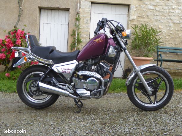

Ming wrote:...It could well be on the road before winter. :D
Hmm - I wonder if I could push my dear wife to another 'project' (besides the 250) - this has just turned up, running and registered... :twisted:
Re: Winter project
Put the engine in the 350 frame... you will not regret it.. bin the rest.. :)
Re: Winter project
MickeyMoto wrote:Put the engine in the 350 frame... you will not regret it.. bin the rest.. :)
No thanks, I'd keep it as it is. I can scare myself more than adequately on a 350! :shock:
