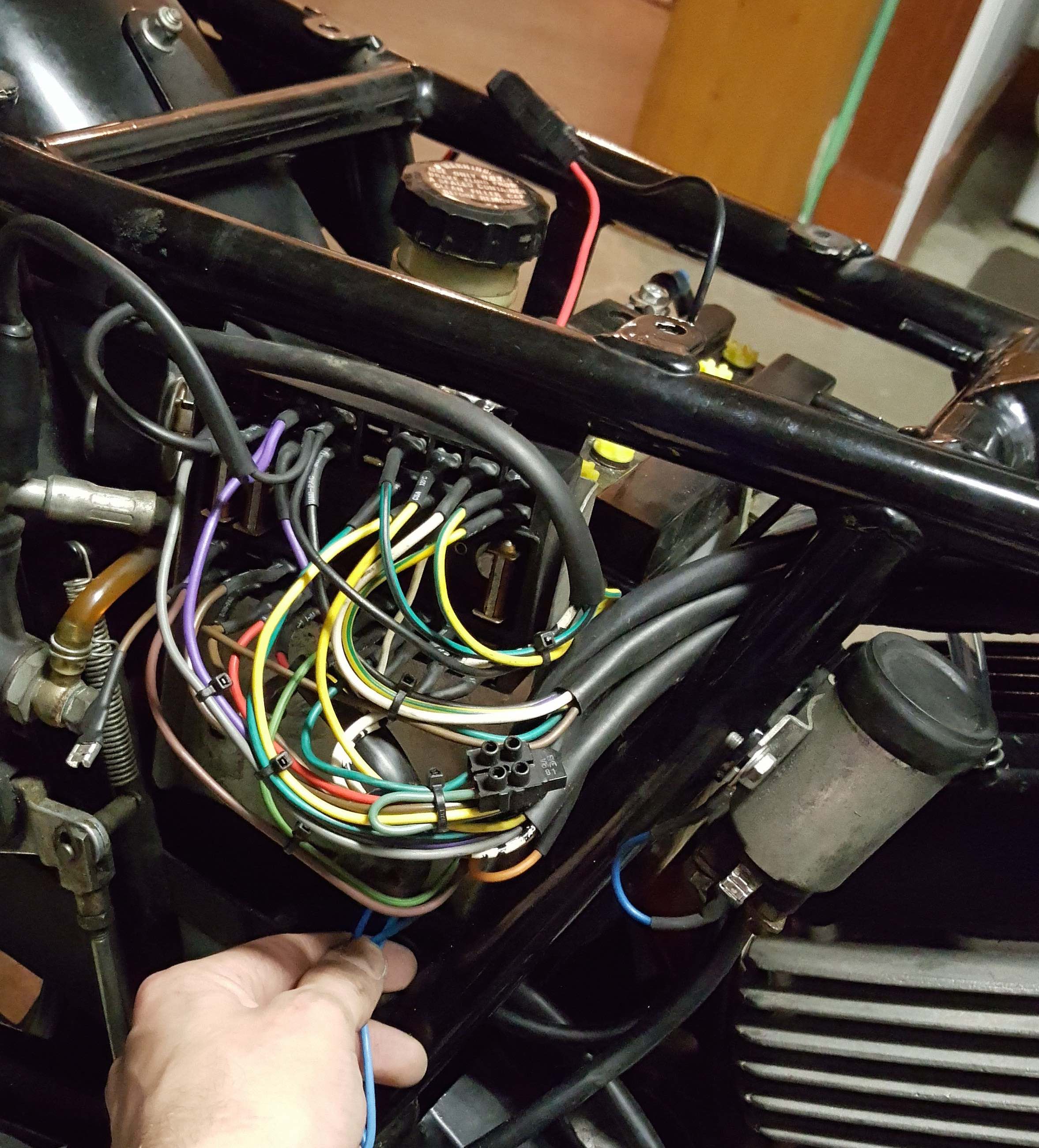

Hi so I am new to the "italian" bikes but I am having an issue with a spark. Bike has (2000miles) on it, and was running before hand. All connections have been redone (New clips), will post a photo of the fuse panel harness.
Fuse Box Panel
Fuse Box Panel
Fuse Box Panel.jpg (497.75 KiB) Viewed 14055 times

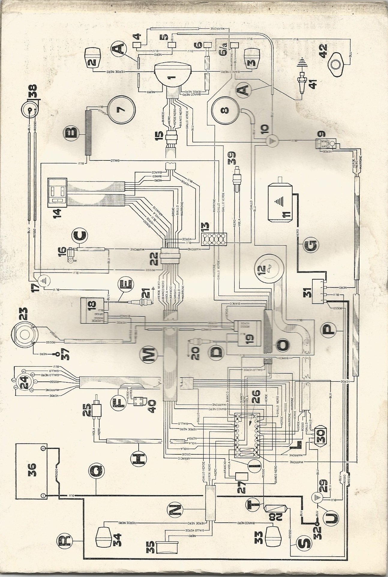

Now every single line is inserted into the correct pin as per from the wiring diagram. I posted the wring diargram from the original manual (NOTE: their are very faint lines inbetween SOME pins that are connecting said pins togeather within "fusebox").
Wiring Diagram
Wiring Diagram
Moto Morini 350 K2.jpg (480.27 KiB) Viewed 14055 times

One issue is (12V) are coming out of the stator (alternator) YELLOW Wires. If im correct only AC should be exerted ONLY when the bike is RUNNING???
So I am wondering if there is anyone who can help me out on this issue and has any experience with this electrical system or possibly this may be the wrong manual? the bike is a 350 K2 but is their a possibility a different electrical system on a different year or half year....

Also would anyone be able to help me on HOW I should properly bypass other electrics in order to get a spark. (Wiring for Eliminating Process).
Posts: 1565
Re: *** Moto Morini 350 K2 Spark Issue ***
ApriliaRSVR wrote:Also would anyone be able to help me on HOW I should properly bypass other electrics in order to get a spark. (Wiring for Eliminating Process).
Disconnect all the alternator wires under the side cover. Make up a connection from the green one to run direct to one of the transducers (Green (verde) connection). That will do just to see if you get a spark on that one transducer's HT lead/plug. A male spade crimp-on connector on one end and female on the other, on a suitably long length of spare wire. On a 250 it's easier because the transducers are down by the reg/rec. On 350s they are usually under the tank so the stator green cable won't reach without an extension. If you do, then the ignition switch/circuit isn't at fault.
It's been 20 years since I had a K2 though so I may be misremembering - like the extra white wire and different reg/rec. Your photo is certainly not of the very earliest type of those but Evguru will advise. Watch his fault finding video and Sorens guide on Youtube.
