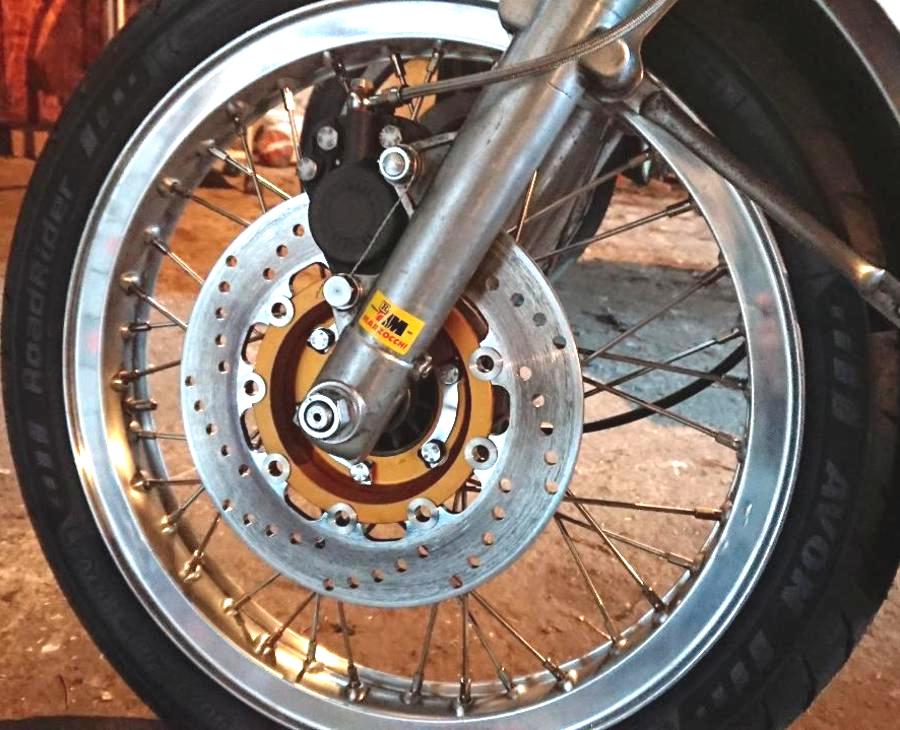

Re: Possible disc replacements
This is the disc that I bought from NLM and which sorted my brake problems and gave me great feeling brakes with no squeal. They also look superb.
Yes, really nice.
Is it more or less expensive?
What worries me with this replacements is if in case of the second disc on the right there is enough room for the odometer cable.
What do you think?
What do you think?
It was a similar price and worth the money. It is very well made. I would like to add the second disc to the right hand side sometime in the future and it looks like it would be possible with a little fettleing.
- Posts: 1662
This looks like a good replacement! You say it gives better feel etc, is that with the standard master cylinder still in place?
