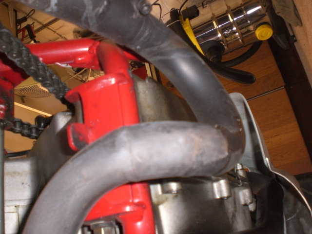

Re: Exhaust link pipe.
In the case of Fridegotto there was this loop under the crankcase in order to equalize pipe lengths.
- 350 racer 011.JPG (242.96 KiB) Viewed 20016 times
Like Db7gtgrigio I once queried that Morini 350 pipes aren't the same length however you measure them and I also didn't get an understandable reply.
Are they in fact not of equal length or am I, like Db7 somehow missing the point?
