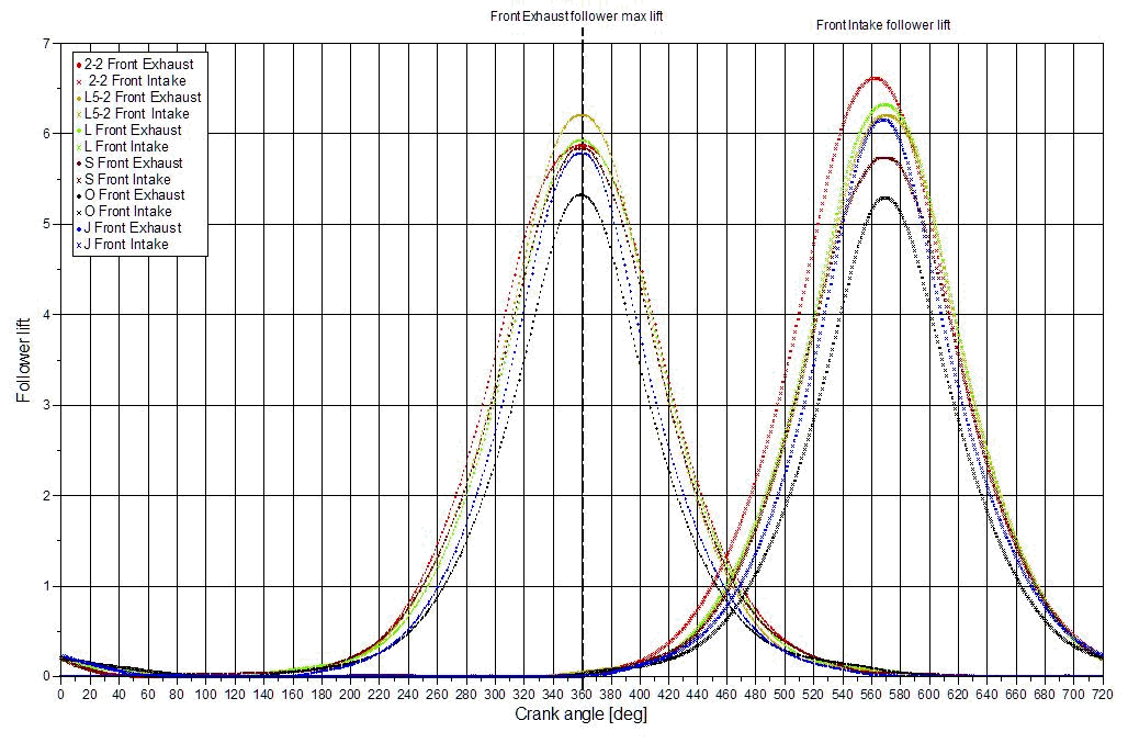

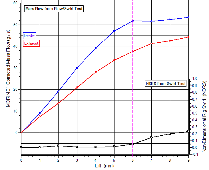

Robert,
I can't help with info on a short stroke 350 but can share some data I collected when building up my 501 motor.
I was able to flow test and take port moulds from the standard 501 head. Also, I measured lift curves for all of the camshafts available to me.
Bear in mind the cam lift curves are knifedge cam lift so you would need to factor in follower width, profile, pushrod and rocker kinematics and rocker ratio to get true valve lift.
The sudden change in the gradient of the mass flow curve after 6mm valve lift (plateaus at ~50g/s at STP) suggests that possibly the air flow is detaching from the port and generating some kind of charge motion.

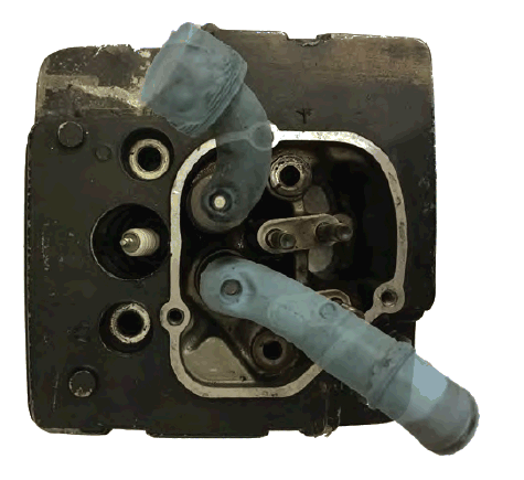

The magnitude of swirl is quite low although I never got the complete story as I did not do a tumble test, so it's not clear whether the charge motion is intentional or indeed beneficial.
As the performance cams have significantly more than 6mm valve lift, it's probable that their airflow potential is limited by the ports.
I went ahead and ported my head, although time constraint to get the motor built meant I never got around to flow testing it afterwards. Certainly feels like an improvement by Arse dyno though. Certainly on a short stroke motor a 501 (or 500 if you can't get a 501) head would be a big improvement.
I'll post the pictures of the flow and lift curves later
