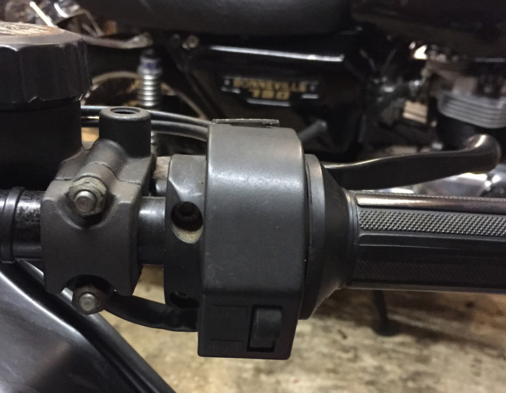

There is one small part I have been unable to get anywhere, and that is the small black cable restraint for the twist grip. I've never seen one, but it must look like a miniature pair of binoculars. It looks as if it clips into the rectangular hole in the twist grip, to hold the outer part of the throttle cables. Again, if anyone knows where I might get one, or has one spare, I would be very pleased to hear about it. At the moment I have a home-made bodge which works, but isn't entirely satisfactory.

The identity of the twist grip manufacturer might be clear if you had the bit you seek! It's a Verlicchi unit. I always have to carefully put mine carefully somewhere safe if I disconnect the cables as the cable block is inclined to fall out (or tape it up with gaffer tape if being left for a while).
I've never seen them offered for sale as a separate item. The good news is that the twistgrip is common to all the twins I think, though apparently the block 'thickness' may differ on some and so affect suitable inner cable length dimensions.
There is a complete unit on Ebay.it (a good source for rare stuff if you search in Italian and use Google translate to communicate with the seller)at the moment. The bad news is, that given the state of the pound, it would be 40 quid plus carriage :(
The 250 I recently acquired had a home made 'block' and it worked OK even though the tube was also fairly shot. Fortunately, I had a spare twistgrip kicking around in the "never throw anything away" shed. A strategy which has borne fruit several times recently.

72degrees wrote:The identity of the twist grip manufacturer might be clear if you had the bit you seek! It's a Verlicchi unit. I always have to carefully put mine carefully somewhere safe if I disconnect the cables as the cable block is inclined to fall out (or tape it up with gaffer tape if being left for a while).
Thanks for that. I did see that twist grip on ebay.it but it looks like a metal unit - mine's plastic, so this wouldn't match, maybe no big deal. Also, the seller doesn't accept Paypal, so making payment might be tricky. I am considering it though and I might contact him.

Post by EVguru »
Electric start twistgrip.

EVguru wrote:Electric start twistgrip.
Good point!

Would the cable block be different ?
Your question got me up off my backside to check and take a photo! I hope this shows it well enough:
The kill switch and starter button are built into the housing of the twist grip hub. So that one on the ebay.it site would cause more problems than it would solve unfortunately. I am beginning to think that making a tidier diy job might be the line of least resistance.
While on the subject of the twist grip, after a couple of hours on the bike today, I was starting to find my right hand aching from the throttle. I don't get that with either the Bonnie or my modern BMW. The BMW just has a MUCH lighter throttle, so that explains that one. But the Bonneville may be a bit lighter, but the main difference is that the grip is thicker and softer, so you don't need to hold it so tightly. Has anyone changed their grips for this reason?
