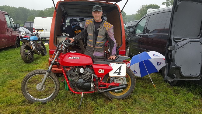

nice looking bike fastharry, i cant see bigger carbs making performance any better unless you go with bigger valves , ive got pod filters on my sport and it performs fine in fact i thought it ran worse with the original air box it was very rich and the engine wasnt as crisp off the throttle others will have different views,anyway great bike and all the best. muller.
