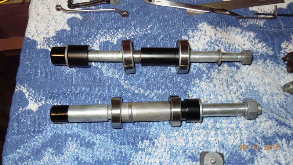

You have to be careful with the rear bearings as there is a 'sleeve'/shoulder in the centre of the bearing & is part of the bearing spacer. All I did was get a very, very good fit bar & drifted it out & one bearing out.
The idea way is to use a press. hydraulic/fly. Use the old bearings to fit the new ones.
Top axle is rear.

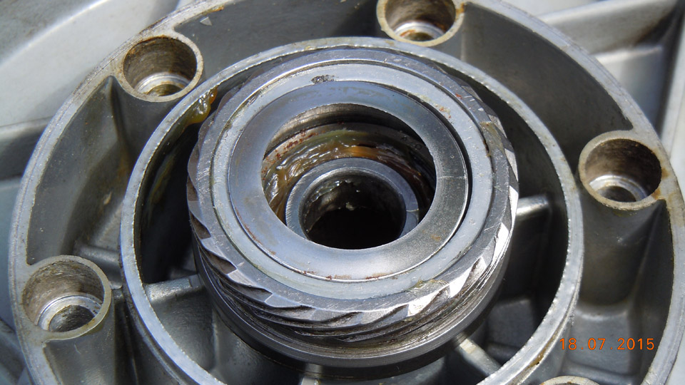

These shields are not required when you fit double shielded bearings
[img]
[/img]
I found fitting new bearings to the front on the speedo drive side to be particularly awkward/tight.

If you have a model with cast wheels, then there can be a build up of corrosion outside of the bearing on the speedo drive side that makes the bearing particularly tight to remove, and in extreme cases it can 'burst' the speedo drive gear wheel when you do move it.
The best thing to do is to use a 'Dremel' or similar to remove any powder coat and /or corrosion from the hole outside of the bearing first. This may also apply to spoked disc hubs and drums too, but as I haven't ever worked on those I don't know.
