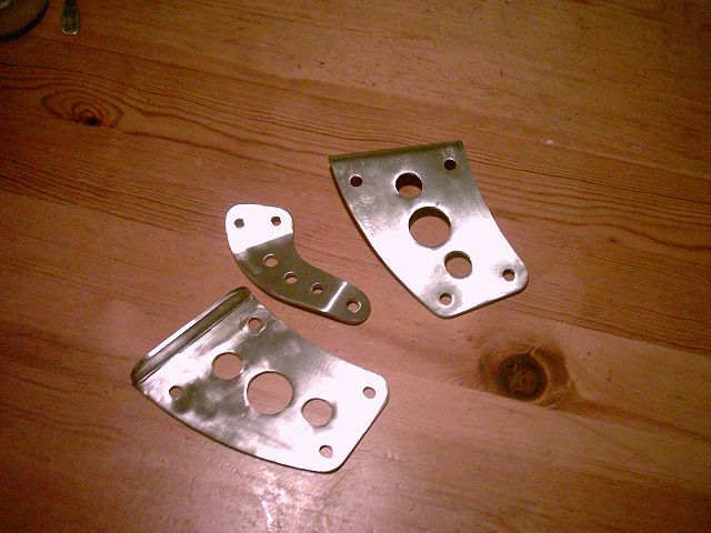

Re: Engine brackets
These are the brackets of the old frame

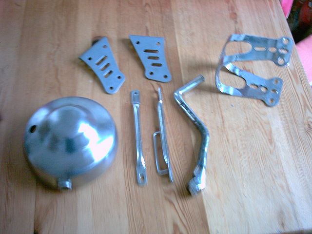

and these for the bended frames (beginning with the first K-model, I think)
