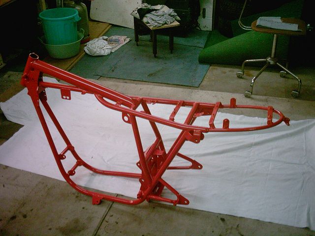

This is an old frame from ´74, without the knick. It´s modified, but you can see the two front downtubes are straight:

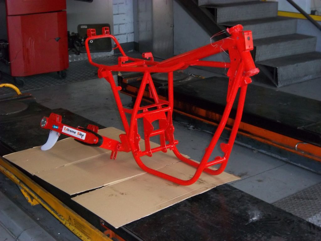

Meanwhile this is a knick frame, the two downtubes are slightly bended (the frame was also modified to build a racer):

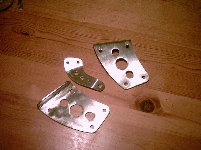

the engine plates of the older models without a knick look like this
The engine plates are diferent in sizes, you can not use the old plates with a knick frame or reversed.
