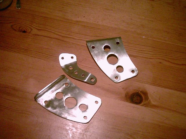

If the engine plates look like this;
Then it's a kink frame.

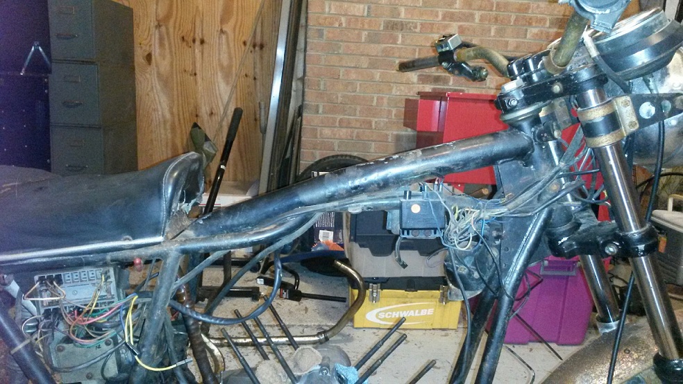

Top Tube pic
Top Tube pic
Looks bent to me, what do you think?
EVguru
Posts: 1530
Joined: 01 Aug 2006 11:13
Location: Luton
Re: Kink frame
Post by EVguru »
Oh, that's bent all right!
The intentionally kinked downtubes bend in the opposite direction and the top tube is straight.

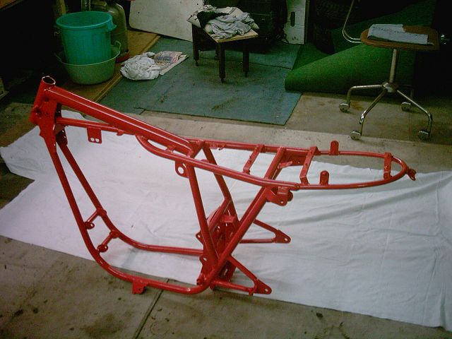

Posts: 929
Re: Kink frame
:shock: this frame really is bended! Iwould say it is scrap metal :roll:
This is an old frame from ´74, without the knick. It´s modified, but you can see the two front downtubes are straight:

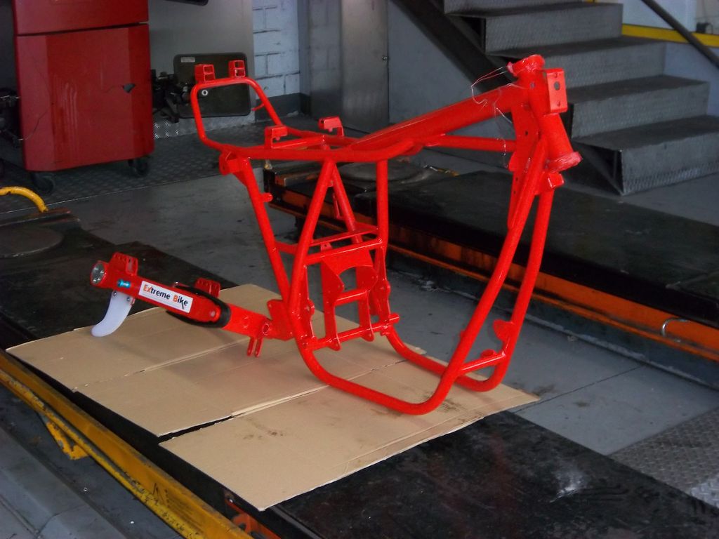

Meanwhile this is a knick frame, the two downtubes are slightly bended (the frame was also modified to build a racer):
the engine plates of the older models without a knick look like this
The engine plates are diferent in sizes, you can not use the old plates with a knick frame or reversed.
I´m not absolutely sure but believe that only on the old frames the fuel tank is fixed at the stearing head with screws meanwhile on the knick frames it is fixed at the front on theses rubber things (don´t know the right word for it :roll: )
"crash victim alert"
it is going to be pretty tough (not to say impossible) to get this on straight again...
(if it is going to the scrappers but the frame still got all the paperwork I might be interested in the frame number plate under the battery tray and docs :mrgreen: have a german 3 1/2 without paperwork)
