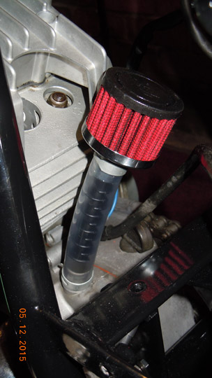

My breather setup & seems to be OK, doesn't smell of hot oil after a run anymore. Only had one air/oil seperator ever since we owned the bike.
Was warned that you have to have the separator fitted!!
