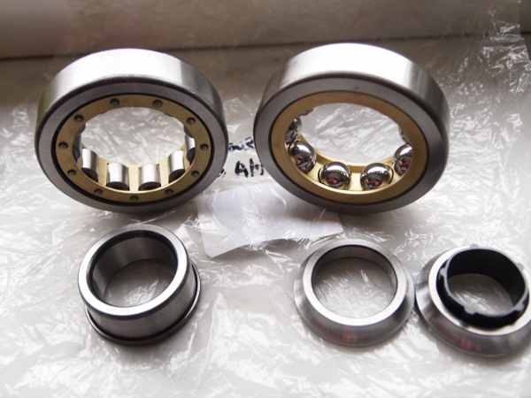

Yes NLM can sell you the bearing and arrange to have your crank ground to take it if it's the later plain bearing type. The bearing itself is just a standard roller type NU206 with C3 clearance. If you really want the best then one with a steel or bronze cage would be ideal.
Here's a couple of pictures of the bearing from Raymond Hamaker photo site;
http://mantaray.zenfolio.com/p396126308/e43d049e
http://mantaray.zenfolio.com/p396126308/e4d5c059
I buy most of my bearings from http://www.simplybearings.co.uk

Next time i use the NJ 206 M with bronze cage
Re: crackshaft bearings
Posted: 02 Oct 2012 11:44
by mantaray
This are the ones with bronze cages
NJ206-E_M1A C3 and Qj306MA

Hi, sorry to ask what is possibly a obvious question, but is there any difference between to two types shown? Which ones are best? the roller type or ball?
Thanks, Tony

Alfonso70 wrote:Hi, sorry to ask what is possibly a obvious question, but is there any difference between to two types shown? Which ones are best? the roller type or ball?
Thanks, Tony
The roller bearing replaces the timing side ball race on an early engine or the plain bearing on a later engine (requires grinding the crank).
The FPAC (four point angular contact) bearing was used on the 500 engine rather than a plain ballrace. Although it's really designed to take axial loads, it also has a higher radial load capacity compared to a standard deep groove ballrace. It's probably overkill on a 350 engine, but it does make dismantling the engine much easier because the inner race is seperable.
FPAC bearings were also used in the 500 gearbox.
