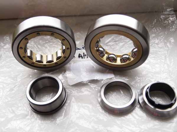

Next time i use the NJ 206 M with bronze cage

This are the ones with bronze cages
NJ206-E_M1A C3 and Qj306MA

Hi, sorry to ask what is possibly a obvious question, but is there any difference between to two types shown? Which ones are best? the roller type or ball?

Alfonso70 wrote:Hi, sorry to ask what is possibly a obvious question, but is there any difference between to two types shown? Which ones are best? the roller type or ball?
Thanks, Tony
The roller bearing replaces the timing side ball race on an early engine or the plain bearing on a later engine (requires grinding the crank).
The FPAC (four point angular contact) bearing was used on the 500 engine rather than a plain ballrace. Although it's really designed to take axial loads, it also has a higher radial load capacity compared to a standard deep groove ballrace. It's probably overkill on a 350 engine, but it does make dismantling the engine much easier because the inner race is seperable.
