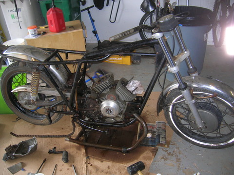

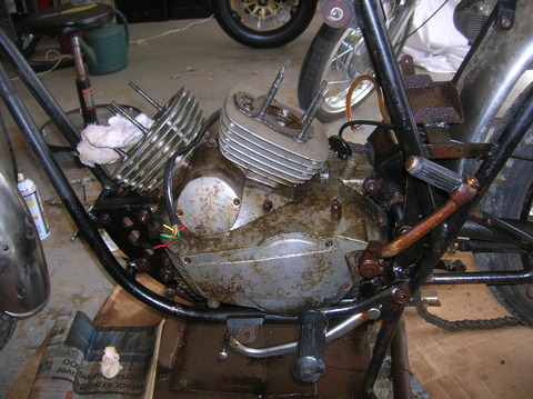

Greetings, new owner here looking for some help and parts hopefully. The motor was completely seized but is now free. I plan on getting the motor out of the frame and splitting the cases for a good cleaning and bearing replacement. I'm putting together a shopping list of parts that i'll need. The stock pistons were damaged in freeing the motor. The compression rings are seized in their grooves. I'll need a set of pistons, most likely 2nd oversize(.4). Both the exhaust and intake valves are pitted and pretty rough. They will need replacement as well. Will need a cam belt, gasket kit, and seals. Looks like Stuart at NLM has everything I need. Here's a few pictures

Guys, I am going to split the cases. Is it ok to split them from the magneto side? That should leave the transmission and the crank still in the kick start side. Any tips on splitting them? I usually tap with a rubber mallet and lots of heat.

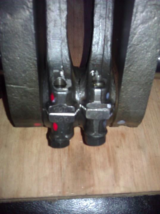

1. The rod bolts are different lengths. The clutch side rod has shorter connector bolts than the mag side rod, reason for alarm....?

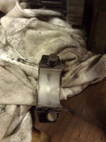

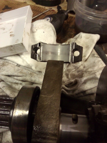

2. Bearings look worn, guess the crank needs to be inspected

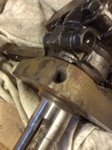

3. Pulled the clutch side crank journal plug out and thought there was metal behind it. The passage was completely blocked. Its clean down to the crank now.

The big end lower shells don't look badly scored, but what are the upper bearings like? If they don't look scored either, then the only way to see if they are worn beyond service limit is to measure them. The crank gallery being blocked is a sign of insufficient oil changes in its past, as the 'oil filter' is really only a strainer. (The centrifugal force of the crank spinning will throw any metal particles and other 'debris' to the outside of the hole along the big end journal.) If it were mine, for the relatively small cost involved, I would replace all the shells as a matter of course. The only question being whether a regrind is necessary or not.
Regarding the big end bolts being different, I think early motors had small bolts, and were upgraded to rods with bigger bolts. If you have one rod with small and one with big, then it is probable that something has gone wrong in the past. If it were mine, I'd replace the small bolt rod with a later one. Morini didn't modify many parts on the bikes without good reason, and breaking big end bolts was one of them. Whether the rods can be machined to accept the bigger bolts I know not as both mine have the later rods. Paul or NLM should be able to advise you on that.
Regarding the heads, if pitting is evident on the flame face, then skimming might clean it up, then again it might simply uncover more porosity in the casting. In the car industry, a process known as 'smear milling' has been used to cover it - involves milling with a slightly blunt cutter that 'smears the metal being cut into the holes! Unless it is really bad and is porous to the outside, then it is probably ok. Valves and seats can be recut and lapped to recover them.

I'm pretty sure George was asking what the upper big end shells were like, your pictures aren't explicit as to which shells are shown.tobydmv wrote:Small end bushes look fine. I will measure them to be safe. The gudgeon pin tapped out very easily.

Not sure what happened here but it looks like mismatched rods. Kind of hard to tell by looking but the red rod bolts dont pass through and it looks like the rod bolt holes were drilled offcenter.
