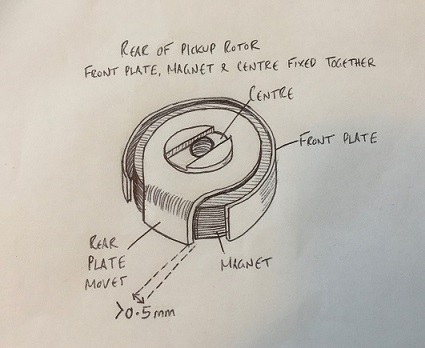

When in doubt, draw a picture. The movement of the rear plate is stiff and rotational rather than lateral, but can't be helping.
I checked the earth wire is still soldered on the pickup and also retimed the ignition to ANT at 6500rpm before making a couple more videos.

The original poster drew the rotor, no good rotor I have has any movement whatsoever of the rear plate, relative to the front.
though I have one where the magnetic material has gone soft - how did that happen?
Sadly I don't have a good rotor of the first type for you to try.

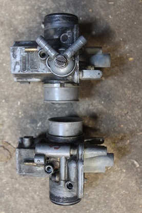

The VHB BSs have had a lot of attention. An ultrasonic bath, new o-rings, seals (including choke), needles, various sized pilot jets, many float height adjustments and countless mixture screw settings, and quite a few re-balancings too. Settings now are stock except for 48 pilots, and these are getting swapped back to 50 before I ride it. The slides don't look that bad, but then again these are early versions of this carb, with no takeoffs for a balance pipe. Perhaps the bodies are worn where the slide moves? I remember there being a fair bit of play when I wiggled the slides, but don't have a frame of reference.
It's true I swapped the carbs for some HSs but I think these were more worn. I had to swap the internals over from the BSs because they were just empty bodies. They actually ran worse.
I could photograph the slides I'm using? Like I said, they look okay but no frame of reference. I'm open to trying different carbs, even considered Japanese but it would be tricky getting them to fit. Then of course the long road of jetting... PHBH seems like the easiest alternative. I've seen Dell Orto still make them, mostly for scooters?

I think the new pick ups from Nuovaray cost less than that, though I haven't checked recently. Also that pick up rotor of yours-the amount of movement your excellent drawing shows is quite significant. It that's 15 degrees at the pick up it's 30 degrees on the crankshaft. That would be enough to make the idle rpm drop or rise, depending on which way it was shock loaded when you last blipped the throttle. Left to it's own devices it seems to idle pretty well for a bike that hasn't had an Italian Tune up recently.
So I'm thinking when it's idling nicely and you blip the throttle quickly as in the video, the pick up moves and gets left behind slightly so retards it and the revs drop and it stalls.
When you've been holding it at higher revs for a while, again like in the video and release the throttle, it gets shocked the other way and has moved to the over advance position and hence idles faster until the rotor has time to catch up with itself. Maybe why you think the timing has moved from where you last set it?
