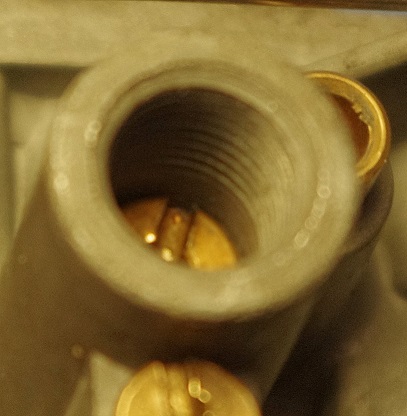

That really is mysterious. Do you mean the thread that the atomiser jet screws in to is pitted or the carb choke tube around that area? No sign of actual cracks?

72degrees: Sorry, what I was trying to say is that the threads are in good condition, it's the outer tube where the atomiser, main jet, throttle needle and so on fit - not sure if it has a name! The central part of that tube, between the atomiser thread and the main jet assembly thread is deeply pitted on both carbs. The actual threads themselves are OK. In other respects, these carbs look practically brand new. There are definitely no blockages or partial blockages in any passages. By contrast, George's carbs are dead smooth in that atomiser area, no sign of pitting at all. The venturi area on my carbs looks as good as new and there are no visible cracks anywhere. I don't think the pitting is deep enough to have perforated anything, though of course it's hard to see down there! Nothing visible on the outside.

Ah, do you mean the area in this not very good photo (though the atomiser is back in) ? I may try again on manual focus (with the atomiser out) on my cheapish DSLR rather than auto. Not sure how that could effect mid range carburation except possibly holding a tiny bit more fuel in the pits so that a smart opening of the throttle sucks more in than it should, but I don't really see that could supply fuel to the atomiser any quicker than the main jet is able to anyway.
From what you have said, it has never run properly in your ownership. I can find no mention of Dellorto motorcycle carb *bodies* being different for the USA market for emissions purposes, and if so you would expect them to be marked as such somehow, but it does make me wonder, when they have been identified as the variable at the root of your problems. I know from posts on the Euromoto list years ago that Guzzis in particular ran very nastily until re-jetted to Euro spec, but that was easily achieved.

Yes, that's the area I'm talking about. The pitting is further up than the slotted end of the atomiser and extends through the area between the two threads. Like you, I can't explain how this could so seriously affect mid-range mixture - and maybe it doesn't! It's just that this is the only defect I can find on these carb bodies. If this isn't the problem then I really haven't a clue. I would love to find a crack or a blockage because at least I'd be able to understand what's going on.
When I fitted George's "BS" carbs, the bike performed really well, with just a very minor flat spot at 4000rpm. When I tried it again with his "K" atomisers replaced by my "BD" ones, it was better again, more than satisfactory I'd say. From the hole pattern, the BD is leaner than the K in mid range. When I tried the Ks in my carbs, the result was worse than awful, practically unrideable. Even then, rolling on to full throttle, it would gradually clear and it would pull away like a train, though it took as long as 10 seconds of spluttering before it would clear.

The air feed to the atomiser is dead straight and you can poke a pretty thick wire through it, as I've done numerous times, believe me! As you say, this isn't a calibrated jet, so I don't think you can hurt it unless you are really rough with it. Anyway, I think I've given up with those carbs. There is good news though!
I put all my removable parts - jets, atomisers, floats, needles slides and so on into George's carbs and took the bike for a 50 mile ride today. Someone mentioned the "Morini grin" earlier and now I've experienced it at last. In my case part of it is amazement that a 350 can perform like that! OK, it doesn't do a lot below 3000rpm, but from then on it's amazing! Considering the age of the bike and the simple layout, the suspension's pretty good as well. My route included a nice twisty road, but I'd forgotten it's pretty bumpy as well. The K2 handles bumpy corners a lot better than I expected. I came back well pleased with it. Even the fairing, which isn't really a thing of beauty to be honest, works pretty well and kept the wind off me well on this chilly afternoon.
