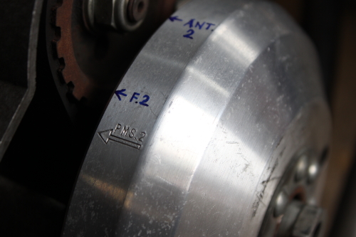

Considering how little difference this made, I decided to have a look at the ignition timing. With a timing light I have noticed the timing mark on the flywheel seems to wander, advancing when the idle speed increased and retard when it slowed. Blip the throttle and the timing retards until the engine stalls. I don't know if the wandering is within normal parameters.

Yes it does seem a little too advanced at idle but from a fast idle to full it's only about 15mm on the rotor circumference.

The flywheel does have pen marks on it to time the idle - I did it back in 2017. I think they are 5 degrees from the PMS marks. I have looked at both marks and both seem to behave the same. It's difficult to tell if the retarding/advancing is causing the change in engine speed or vice-versa. Chicken or egg? Revving the engine seems to highlight the behavior.

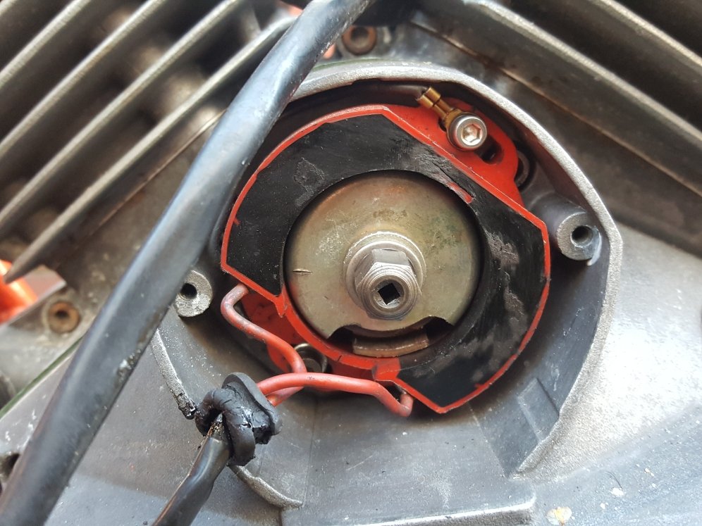

I also have some photos of the ignition setup, which I believe is all stock. The pickup rotor seems solid, the small rear plate does have less than 0.5mm play but the front plate and magnet are solidly mounted to the centre piece.

I'm not sure exactly what you mean about movement on the rotor but I wouldn't want to find any movement on it. It's something to replace for sure.

I agree with Steve the advance at idle is more like 20 to 22 degrees BTDC about where the shiny line is on the rotor as ANT2 is 34 degrees.

Long_Road, this may be an optical illusion and I’ve tried zooming in as far as I can, but in the picture you’ve posted of the pickup it looks as though the short black ground is not connected to the pickup?
I would definitely take off the rotor and check it, as I don’t think there should be any play in the plates, and I wonder if the back plate is moving around when the engine is running.

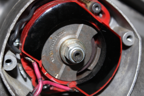

I see what you mean about the black wire - though my eyes are dim. Compare with a shot I took of one of mine just a couple of days ago. It might just be a bit of exposed conductor on Long-Road's , but definitely worth double checking.
