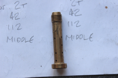

I have told him before that he should write a book on the Lambertini V-twin – his passion is contagious. Spurred on, I moved my attention back to the carburation. The idle jet passages looked clear, but I did notice that the emulsion jets were what I believe to be modified 260Ks. They seem to be okay for the moment so I’ll go back to them once the bike is on the road.

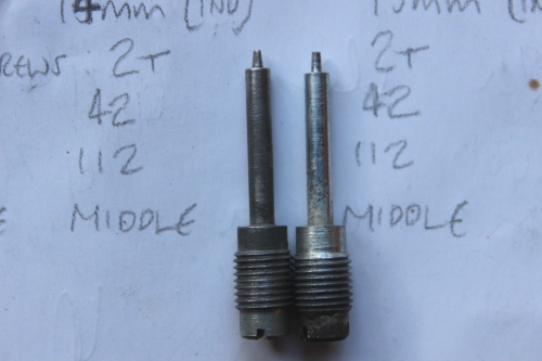

Another interesting discovery is that the mixture screws had a slightly different profile, which may explain why they needed a different amount of turns. Exact adjustment of these is crucial for a decent idle and pickup. I found a matching spare and swapped them over. I later discovered that this tiny difference did have an effect.

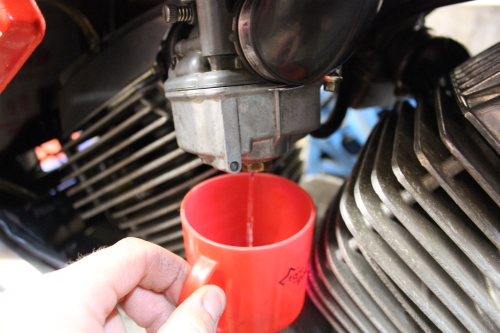

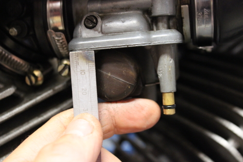

Remembering what Stuart said about adjusting the float levels, I came up with a basic means to measuring the actual amount of fuel in the bowls. Having just a basic setup in the garage I had to improvise with a toddler’s cup marked with pencil(!) but some kind of measuring vial or jug would be more suitable. This method showed me that the L/H carb had more fuel in it, despite me recently setting both floats to the same 11mm from the centre of the float. I then measured and lightly scribed a line to intersect the mould line of the float – not super accurate, but this would give me a consistent reference point for all the float level adjustments I was about to make.
I dropped the levels way down to a measured 16mm to start with, and found that no fuel would enter the bowls. Okay, let’s go up. 15mm and the bike started and ran better than I could have hoped – I could feel with the throttle that the carburation had improved at low revs, and for the first time I achieved a stable tickover! I may at this point have performed a small dance.
Then came the fine tuning. Wow, these carbs are much more sensitive than their Japanese contemporaries – one example, ½ a turn on one of the mixture screws and the engine slows to a halt within 10 seconds. It was at this point I tried one of the different mixture screws mentioned earlier just out of curiosity and there was a noticeable difference in behaviour, it needing a different adjustment to the one I swapped it with. I ploughed on and half a tank of petrol later found a combination which seems to do the trick:

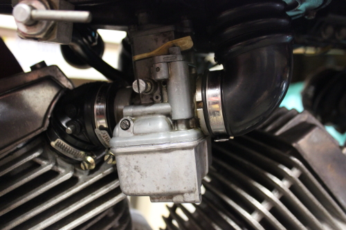

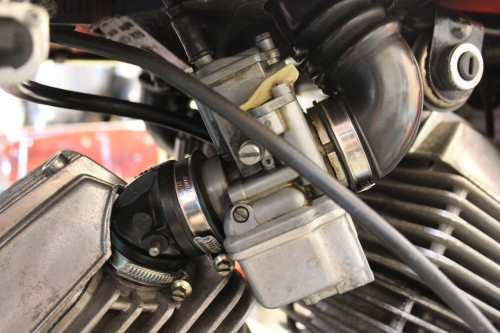

This applied to both carbs, but I found that I needed to set the individual float heights differently (L/H 14mm, R/H 13mm). I believe this is due to the L/H carb being tipped at more of an angle, causing the pilot jet to be submerged further than the R/H carb’s.

In conclusion, what I think may have been happening to cause the poor idle is the fuel levels were too high, meaning fuel was making its way past the pilot jets and filling the idle/low speed circuit, causing the mixture to be too rich at the low air speeds at idle. Give it a good rev and the excess fuel clears, allowing the bike to idle for a short time before the float bowl refills. What is interesting is that I have needed to set the float levels a fair bit lower than what the manual recommends. A glass or clear float bowl would be an extremely useful tool for setup in this respect – I’d be very interested to see what’s happening in there whilst the bike is running. The Dellorto VHBs, in combination with this small-capacity engine with no flywheel, are very sensitive to adjustment; it sometimes felt like I was tuning some kind of musical instrument, which in some ways it is…

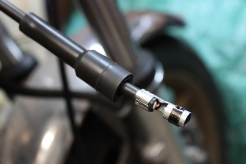

A few other things worth mentioning are that I replaced the spark plug caps with the basic metal terminals, as I believe this is how the Morinis ran back in the day. I wanted to try removing any resistance from the spark, and these were cheap. Perhaps I’m getting a slightly stronger spark at very low engine speeds; perhaps they make no real difference.

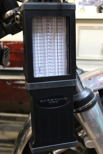

I splashed out on a Morgan Carbtune a few years back, and it has been very useful indeed in setting up the Morini 3 ½. It’s worth getting the carb balance absolutely spot on with this bike, as well the carb tuning.

That's is good news.well worked through. I must have been lucky with mine,though having gone down a size or two? 43 I think, for the idle jet it removed any stumbling. I have always had a good tickover.I've tried to get the carbs as vertical as you can, at least not tilting inwards or outwards.Certainly on my other bikes which both have twin carbs I get them equally vertical. I can measure the fuel volumes using a glass 10 mL measuring cylinder.
As to the plug caps, I regrettably replaced mine with NGK resistor caps and cannot find my originals anymore.
