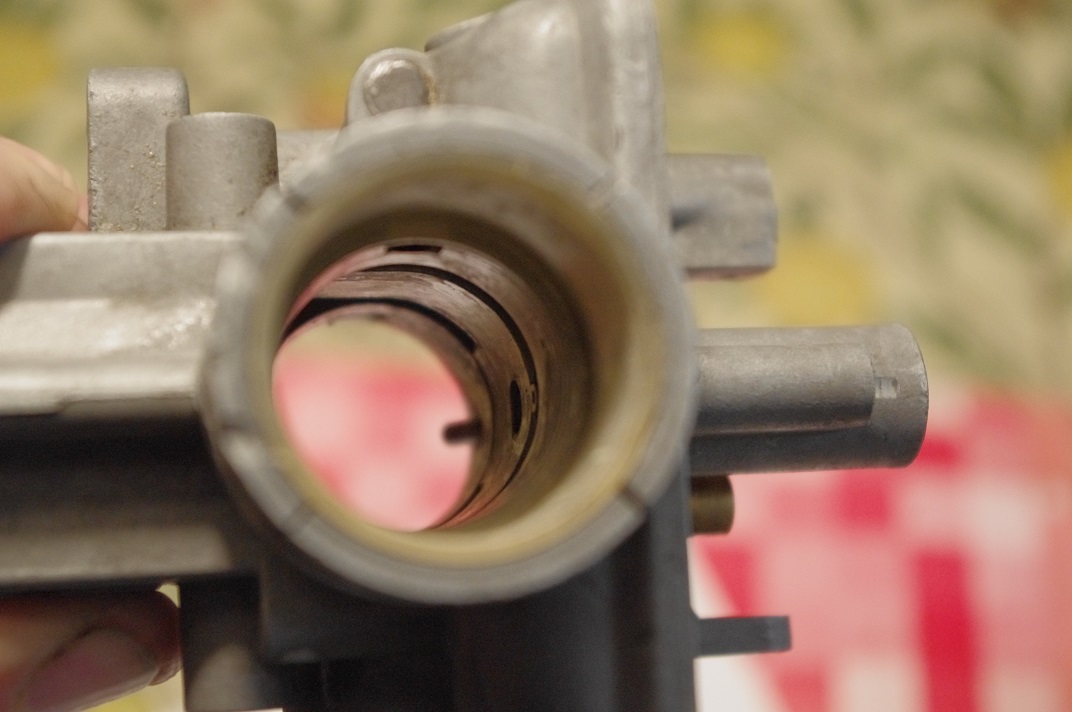

I am now pretty well convinced that the corrosion in the central tube of the carburetter body is the root cause of my problem. If I put all my jets and atomiser into George's carbs, the bike runs really well, just a very minor and liveable-with flat spot, which might well be cured by changing to a CM atomiser. A bit of research has given me two options:

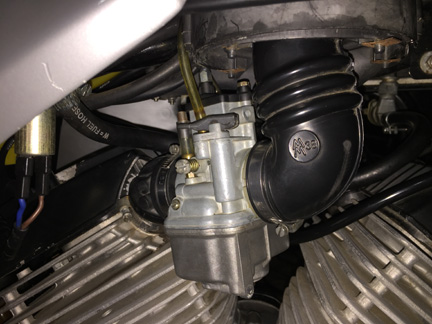

You say your 1986 K2 was fitted with PHBH 28 carbs, do you have a photo of how it mounts? Mine look like this:
If you have the same airbox, the rubber adaptors must be available and you may be able to tell me the jetting.
Once again, thanks for the information!

PHBH 28s are often used on 'tuned' 350s (I have a pair on mine) As you are aware, there are different versions. For a start you need a 4T version. Then you probably want the type that are :
42mm Plain air intake connection.
36mm rubber sleeve type engine connection.
I assume the K2 uses the same screw in steel intake stubs in to the head and rubber elbows as the other late 350s. I had a K2 but never fiddled with it much. Didn't realise they came with PHBH28s as standard but they should fit and work with the connections to the air box OK.
The downside is that in the experience of some (including me) they can be tricky to tune on the earlier 350s as they are really too great a diameter for sweet running throughout the range. Having said that, mine also has an L5 cam, pod filters and 2:1 exhaust so too many variables to blame the 28s alone.
I must get round to ordering a new pair for the 'project'.

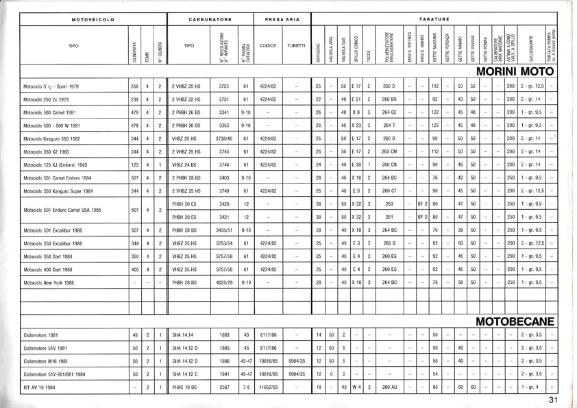

I found the following table among the many things I've downloaded from the web:
It does show PHBH 26 and 28 carburetters used in the 1980s, but only on 500 models. It shows VHBZ 25 HS carbs used on all 350 models up to 1988, and on the 400 Dart. The 1986 K2 with PHBH 28 carbs sounds like a bit of an oddity - perhaps there was a shortage of the VHBZs, or perhaps Morini made some late changes to this model before discontinuing it. I would be interested to know what the jets, needles, atomiser and so on are.
The PHBH 26 still looks interesting, though the scary price of Dellorto parts is a bit off-putting if it takes a bit of experimenting to get the jetting right.
I'll give all this a bit more thought and I'll give NLM a call tomorrow and see what they've got.

penman wrote: It does show PHBH 26 and 28 carburetters used in the 1980s, but only on 500 models. It shows VHBZ 25 HS carbs used on all 350 models up to 1988, and on the 400 Dart. The 1986 K2 with PHBH 28 carbs sounds like a bit of an oddity - perhaps there was a shortage of the VHBZs, or perhaps Morini made some late changes to this model before discontinuing it. I would be interested to know what the jets, needles, atomiser and so on are.
That was a USA market 1986 K2 I think? Perhaps that's why it had PHBH28s - though I'd think big carbs wouldn't fit the usual US emissions mods reasons.
Ha! You should try getting the jetting right on a KTM 2T MX bike if it has been tweaked a bit, though to be fair Keihin stuff is much cheaper. If it wasn't for keeping the project Forgotten Era eligible I might try to graft some Kehin flat slides on to it.

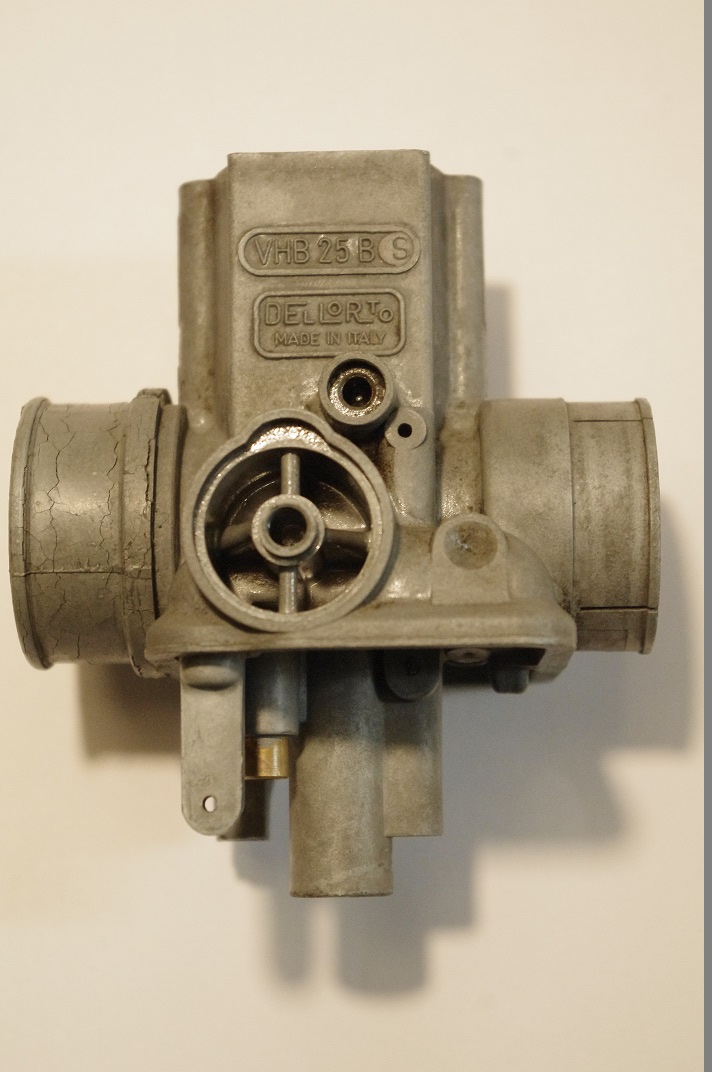

Well I found them. VHB 25 BS. So early, that they still had the clamps for fitting to the early cast alloy intake elbows. They can be used with rubber manifolds with the clamps remove. By the way, if anyone is going for total originality on an early 350 I have a pair of said alloy intakes in useable condition.
The bad news is that the first carb I started to disassemble to put in the ultrasonic cleaner went swimmingly with all the jets coming out easily - except the starter jet (choke) plunger. Budged it a bit but it won't come out. I have it soaking in Plusgas but the brass plunger must be corroded to the body.
A pity, because the slide didn't look too worn at all and the bore isn't hugely furry. They are probably the original set I took off when I first equipped the original hill climb '76 350 with PHBH28s in 1981 !
The starter jet plunger has already been robbed from the other one (as have the float needles from bot carbs and the floats from one) so could probably be cleaned up OK.
I'll leave it overnight and have another go, but the starter plunger bore may be too far gone even if the plunger can be extracted. Anyone got any bright ideas on how to persuade it out?

In fact, with plenty of Plusgas, a little perseverance and a modicum of brute strength it finally started to twist, move a little and then came out. The plunger bore looks not too bad. The body has come up quite nicely after an ultrasonic session. What sort of play is acceptable between the slide and the body? This has a little but the slide doesn't look very worn.
I'll put a photo up once I've finished the clean up in case anyone else might find them useful (I'm assuming the other one will be in a similar state).
