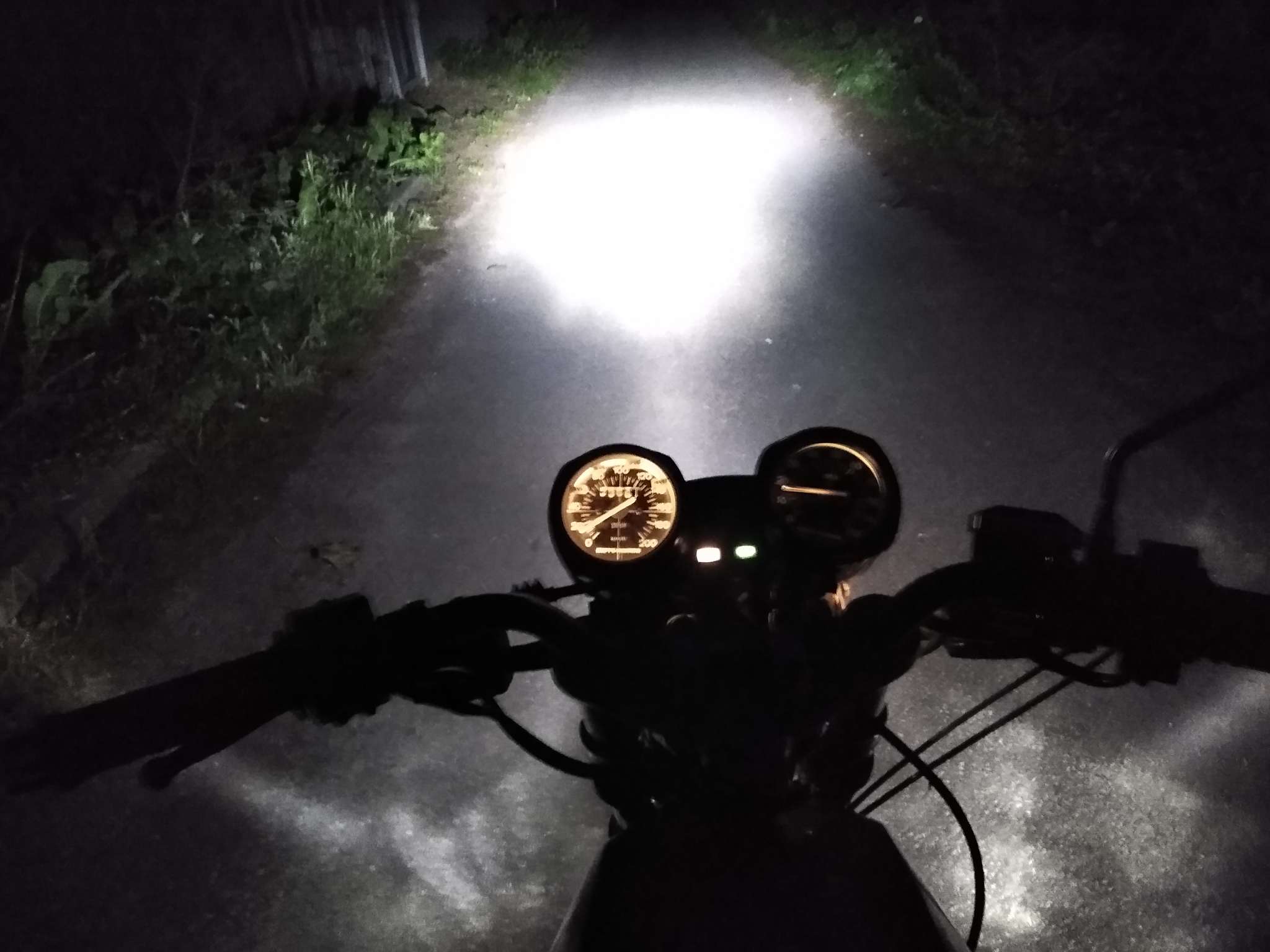

Wow, quite a difference. I'd be curious to see the pattern it makes on the road, too, if you wouldn't mind?

Haven't had a chance to do a night ride yet but weather looks good for Saturday and Sunday night.

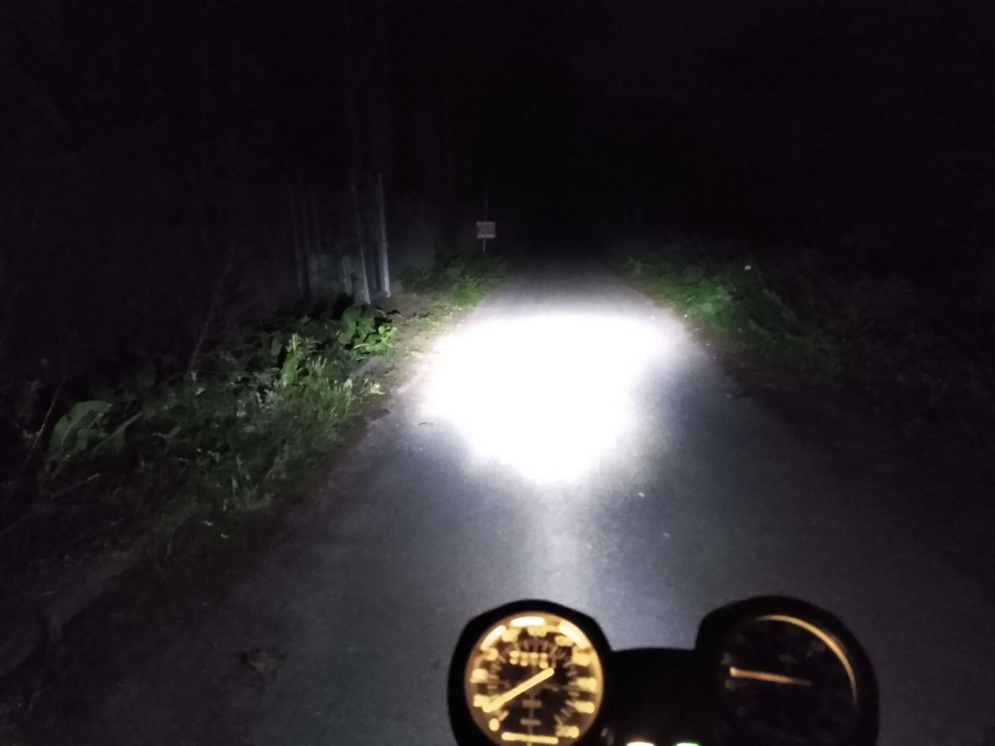

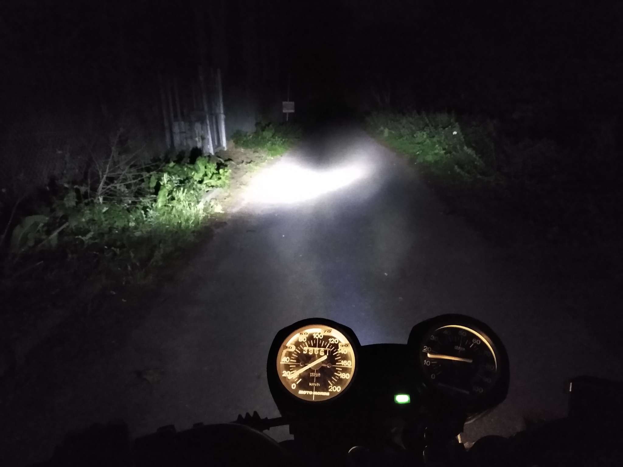

Well I tried the led bulb out and it's going in the bin
Dip is fine Main beam is bloody awful In fact it's lethal I turned down an unlit country road flicked main beam on and I couldn't see a thing just glare. It throws further on dip all main does is light up the sides and road. Wish I hadn't wasted £36.
Third photo is same viewpoint as first it doesn't come across how much glare there is but you can see it doesn't go very far

Yes I would be dazzling other road users. I am going to have a chat with the seller Paul Goff it might be that my rectangular headlight isn't suitable for an Led bulb or I have cocked up fitting it.
It was scary doing about 40mph on a road that I fortunately knew well and suddenly I couldn't see a damn thing apart from glare and the hedge either side of me. There's nothing wrong with LEDs I have a light on my pushbike that is brilliant but it's not the power it's about the way the light is reflected.
I might look for a nice round headlight with a reflector designed for LEDs.
