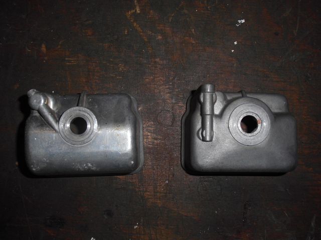

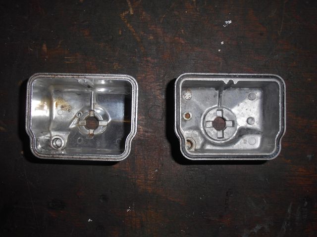

I´got no VHB left, but a float chamber :lol:
k-Schwimmerkammer VHB(Z) 1.JPG (38.96 KiB) Viewed 9139 times
k-Schwimmerkammer VHB(Z) 2.JPG (45.09 KiB) Viewed 9139 times
I guess they can be interchanged.

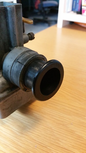

Do you have the carb throat reducers fitted?
These were fitted on all rubber manifold bikes from new and when converting from metal manifold, often they are missing on conversions.

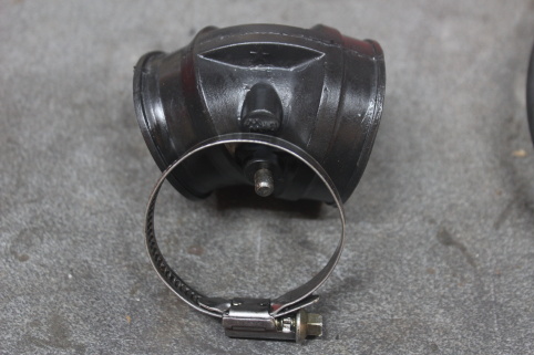

I always use the plastic collars but many don't with no ill effect, the plastic collars do stop bad quality hose clips like Jubilee clips
from eating the rubber. I recommend using hose clips without an external thread so they are smooth against the rubber

Thanks for the suggestions. The carb reducers/converters are indeed present and tight, as are the inlet stubs (one did need tightening earlier on in the investigation).

Also found some wider hose clamps knocking about, which fit the larger area left by removing the plastic collars on the manifolds. After warming the engine I found that it was running richer, and changed the pilot jets from 50 to 45.
