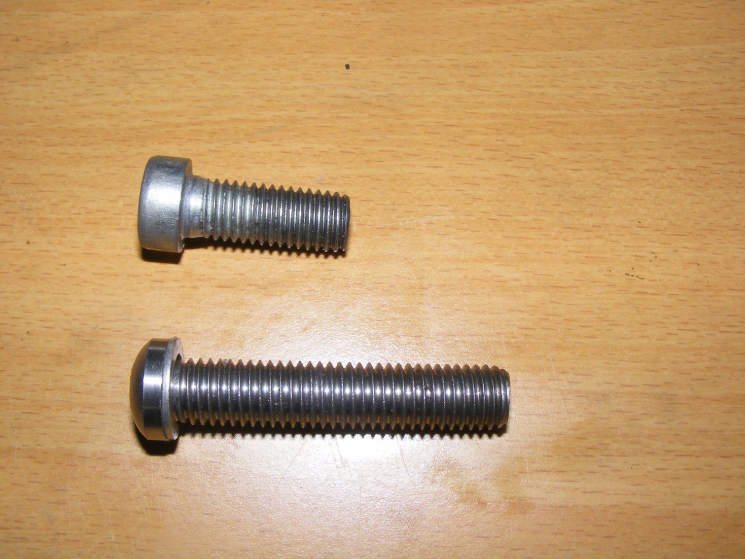

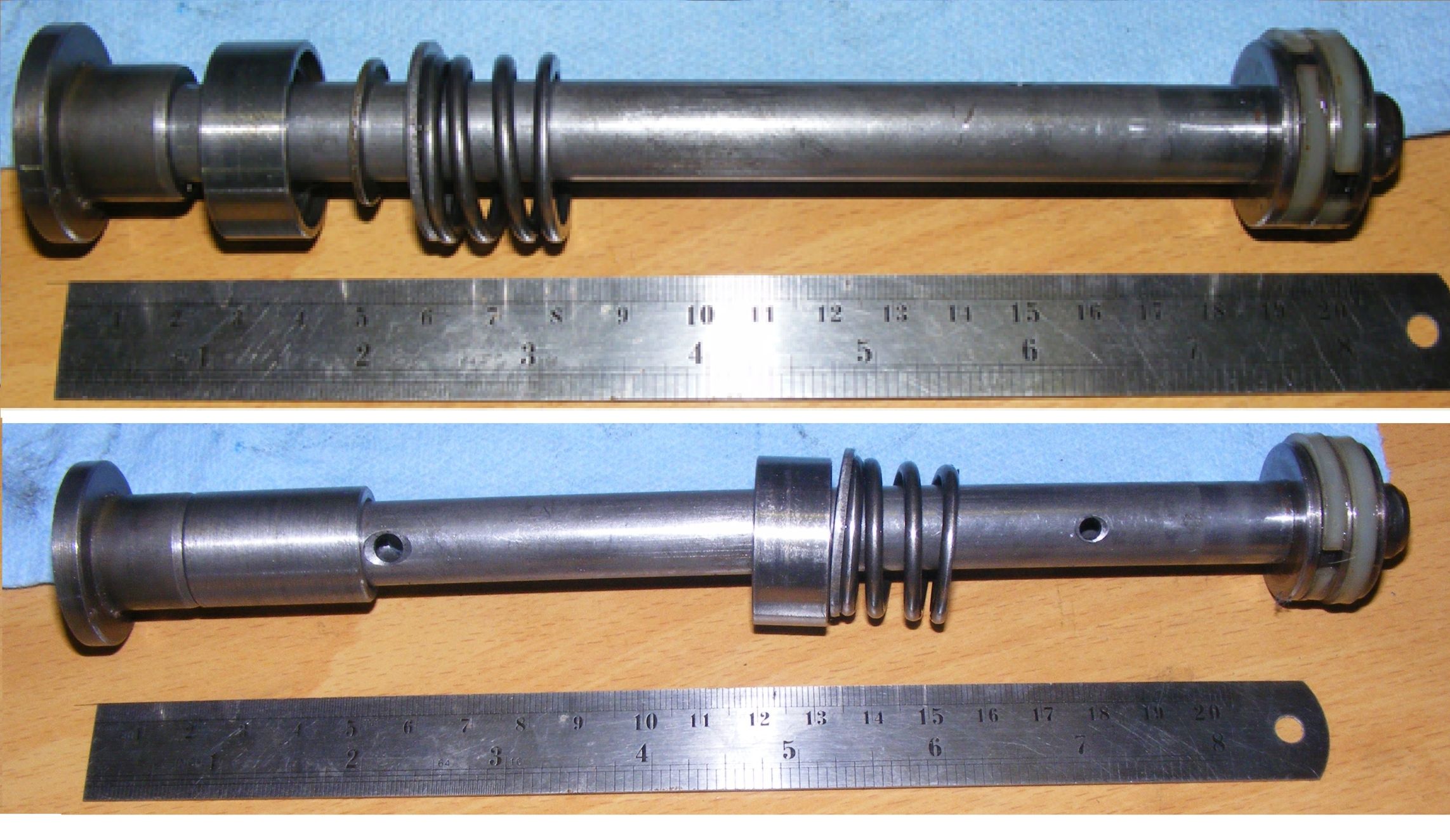

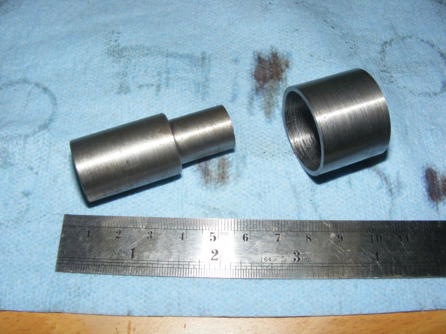

Back then I made the 'error' of believing what others had said in that the Pantah forks were the same as Morini and got a set of Tarozzi Pantah tubes. This was found to be false, at least when I compared my original 1978 bikes forks to what I had bought. I was restoring the bike when I got the new stanchions, so never tried to use it unmodified. As an Engineer by trade, it wasn't something I could leave untouched so engineered a solution for it. It seems like the later K1/K2 forks MAY be the same as Pantah, but I have no idea if they are.
In addition to the top caps,I had to do the following:
1/ I 'moved' the damper assy (from memory) 30mm up the stanchion (I'll have to see if I still have the drawings I made somewhere...) by making spacers to go between the 'top hat' at the bottom, to fill the gap between the circlip and 'valve' in the stanchion, and 2/I shortened the spring spacers at the top by 30mm to compensate.

NB: I had to fit new , longer bolts as well to compensate for the damper moving up.
Bottom line is, it all works.
