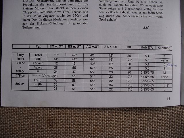

This are the numbers of the cams published in La Strega years ago
I once had a cam marked with "L5", although everybody says L and L5 are marked the same "L".

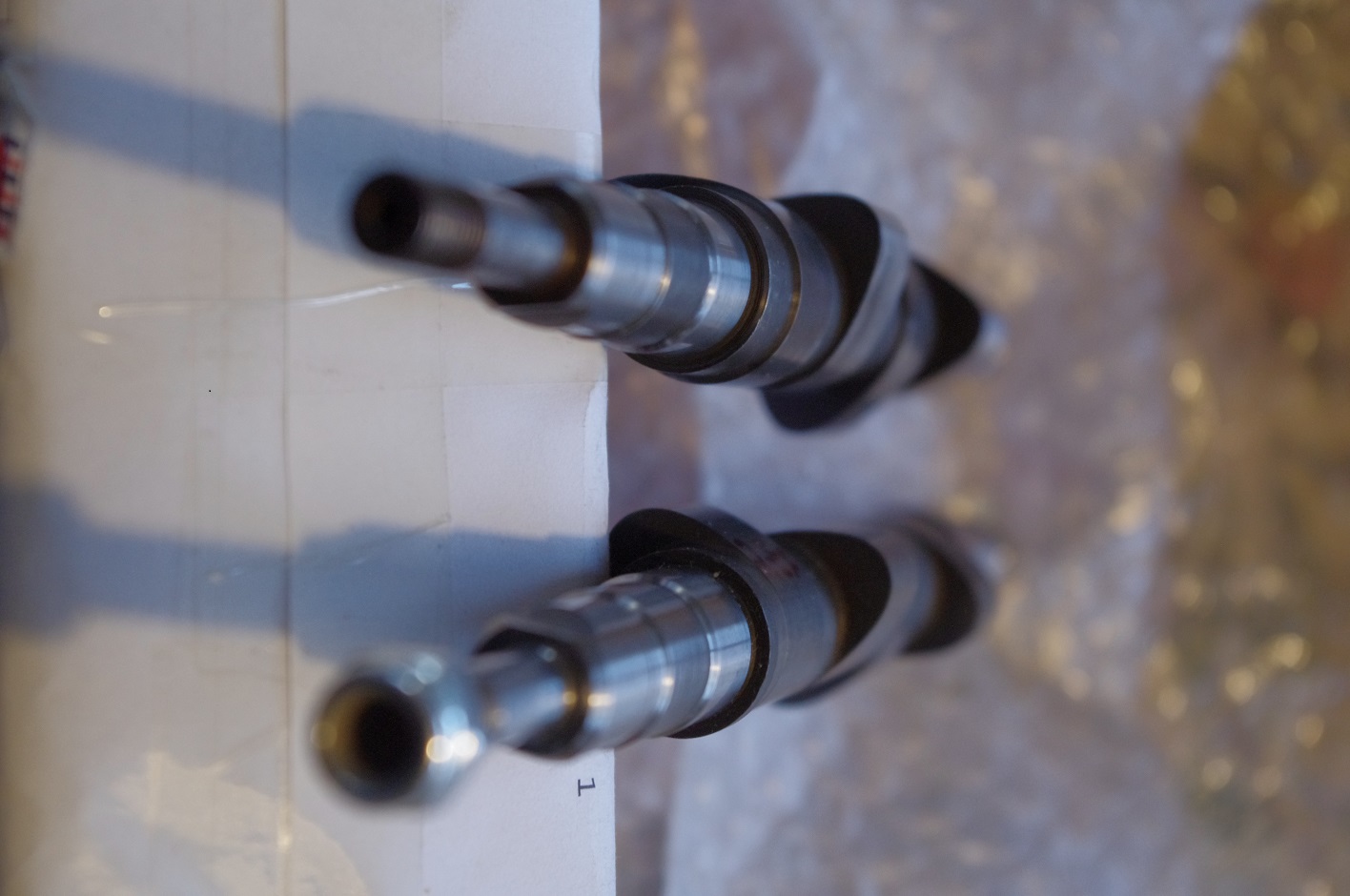

I forgot I took a photo of the 'mystery' cam next to a Strada one. Clearly longer duration, achieved by grinding to a base circle not much more than the shaft diameter but does it look like your 'L5'?
