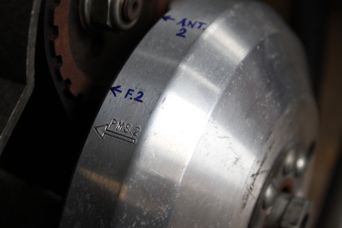

An incorrect flywheel has crossed my mind, I guess with Moto Morini being a small factory means all their bikes were something of a unique mix of old and new models. I’m not suggesting they got it wrong in my case, more that it makes it tricky to ID the definite setup for a given year.
My flywheel does indeed have a PMS.2 stamped on as well as PMS.1 and ANT.1, I marked up an ANT.2 with a permanent pen. The punch mark for timing is in the 9 o’clock position, and all the timing marks align when the pickup is positioned with the moulded arrow pointing to the line in the pickup’s housing. In other words, the timing is spot on. I will check the actual TDC positions and also take a couple of photos shortly – bear with me.

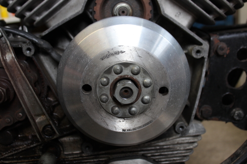

Re: Trying to get beloved Sport back on the road- poor idlin

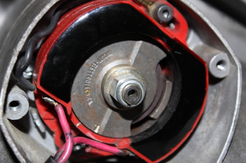

Checked TDC for the front cylinder and it lines up with PMS.1. This is the flywheel, just for identity's sake:
PMS.2 stamp: Ignition pickup, note the alignment of arrow to line:

That's interesting. Reading the blue book again I see that it confused me and that they all had an ANT.1 not just ANT. I just had to go and look at my two to remind me just what they have. The 375 has a three air slot rotor, without electric start drum, marked with just ANT.1 - though the 1 is pretty faint. I'm sure it's not the original rotor from the 76 engine though as that was of the two peg holes variety when I first had it. The racer has the rotor that came on the 1982 (Spanish market) 250. That is a three slot (non electric start) one but definitely has ANT.1 and ANT'.2 marks. I already knew that, because I spent ages recently checking the timing on the NLM performance pickup to get it spot on for both cylinders. Naturally, that could also be a replacement not the original.
Both these 350 engines (76 and 77) have the punch mark on the crankcase and when strobed, that's where the ANT.1 mark (and ANT.2 on the racer) line up with and advance correctly when they hit 6000. Which seems odd if these late rotors were designed to be strobed against the camshaft axis - or were they?
Chris's definitely looks to be an early 2 peg hole rotor with only an ANT.1 mark so should be the correct one to be timed against the crankcase mark not the cam.

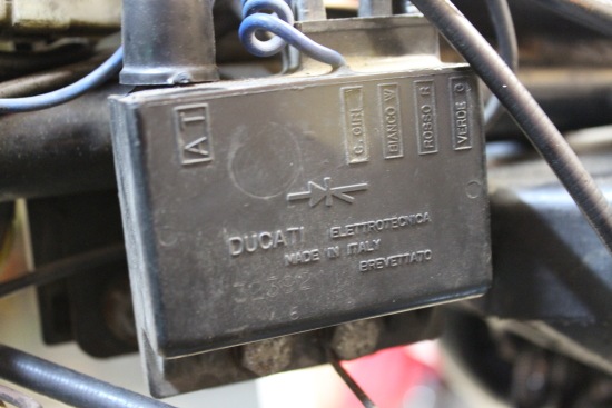

So why the ignition advance is seemingly out is still a mystery. I forget - does it definitely have black transducers with green dots to match the red pickup - not later grey ones?

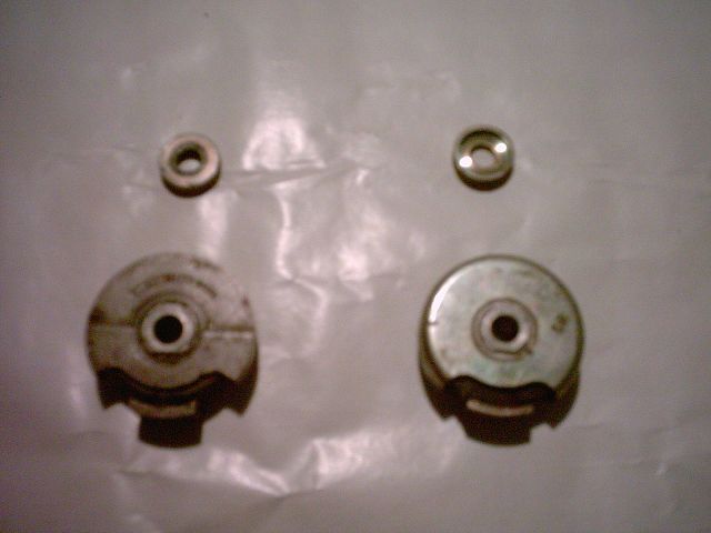

The rotor of the pickup looks like the very first one.
There are two kind of red pickups! Maybe that you have the second generation of red pickup in combination with the first generation rotor? The difernce can be seen if you compare the length of the visible metalic parts (don´t have the right word
) inside the pickup. Right now I don´t remember the right measure of each, but maybe someone could help.
I only have this bad foto of the rotors: the left one is for the very first red pickup. The right one for the second generacion of red pickup as well as for the black pickup:

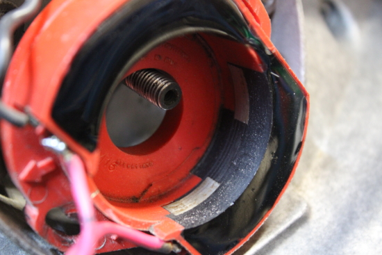

Difficult to tell from the photo but the strips on this look fairly wide - so probably an early pickup that matches the rotor.

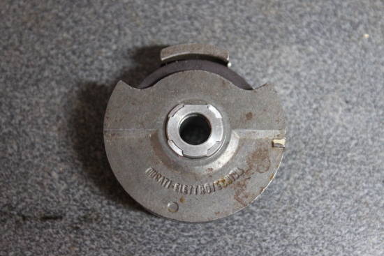

Thanks for the information! No eureka moment for me yet unfortunately, but some more photos may be informative:
Couldn't see any coloured dots on the transducers, but then I don't know where they are.
