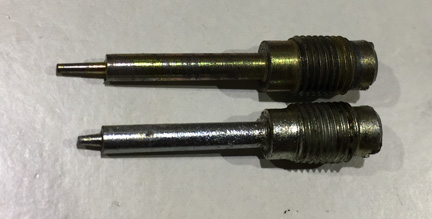

I've started having another look at my carburetters and the first thing I've noticed is this:
This shows the value of having a known working carb to compare with. Mine is the top pilot mixture screw and it has a much longer taper on the end. No doubt this explains why my screw needs to be a good 2 turns out. It doesn't explain the balance pipe issue, but maybe this isn't the only difference in the pilot area. The mixture screw illustrated on the Eurocarb / Dellorto website appears to be the lower one with the short taper.
I have also had a look at the atomiser area. The air feed is via the small brass tube which protrudes into the intake at an angle. This leads down at an angle into the emulsifier tube and (I think) there is a groove running round the inside of the outer tube. There was still some muck in that groove which was difficult to shift, I got it out with a dental pick in the end. There is also some corrosion in that outer tube, I don't know if it's bad enough to affect anything.
If I have another go this afternoon, I'll take one of George's carbs off the bike again and start a full A-B comparison to try to understand the differences and see if I can spot an actual fault somewhere. Any fault has to affect both carbs....!

An update, followed by the points raised by Paul and Fiona - many thanks!
Just to cross off another question mark, I tried my throttle slides, needles and carb tops on George's carbs and as expected, the bike performed well. I then tried George's jets and atomisers in my carbs and it was as bad as ever, possibly worse. I had previously checked all the passages for blockages and they are clean. The fact that the bike idles well tells me that the pilot hole on the engine side of the slide is clear (shoot me down if you disagree!) and as for the hole on the other side of the slide, you can see straight through that if you remove the pilot jet. The air feed to the atomiser is straight, so you can poke a wire through there, quite a thick wire. I really don't think this is being caused by any blockage. I can't easily check the air feed to the pilot, but again wouldn't a blockage there stop it idling? - and it would get better as the throttle rises, not worse.
I am now wondering if my problem may be down to the corrosion in the central tube, where the atomiser sits. It's quite deeply pitted on both carbs and the original atomisers were similarly pitted. I've seen other evidence to suggest that the bike has spent time in a damp atmosphere and I don't know if you get some electrolytic corrosion between the brass and the mazak, or whatever the carb body is made from. Whatever, it's corroded in there and I wonder if this affects the flow of fuel. Other than that, I'm running out of ideas. The carb body is a lump of metal and if it's the right size and shape it has to work. I've compared my carbs with George's point by point and they are identical other that having plain holes for breathers with no stubs and mine having vacuum ports, which I've blocked off anyway.

Paul - thanks for the atomiser info. This is what made me look more closely at the corroded central tube. Not sure what my conclusion is yet though! I did find the breather holes on George's carbs. Those holes exist on mine, but they are blanked. There are some minor differences in the carb body casting, but they really are minor and wouldn't affect how it operates. Destra and sinistra - haha I should have guessed! So I have two left-hand carbs, somehow appropriate!
