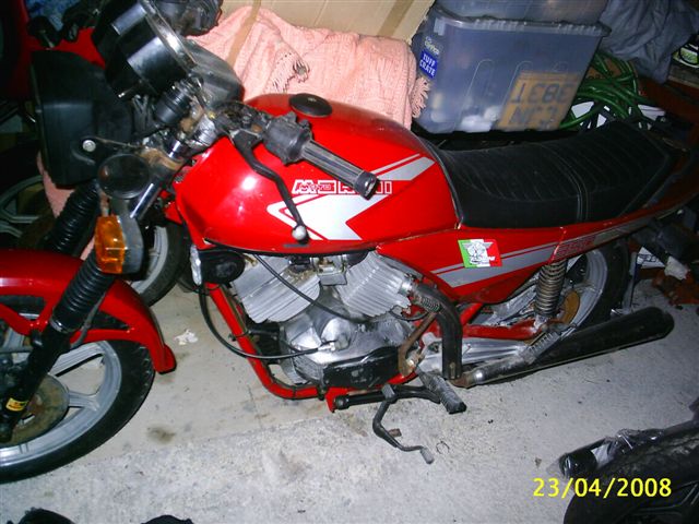

Some time ago I had my K2/sport on here for sale ( about a year ago) - anyhow it did not sell and sat at the back of the garage - I am off work at the moment after ankle surgery and started thinking about the K2
I have just been into the gargae, put a gallon of fuel in and she started second kick! and settled down to a nice 1000RPM tickover !- This has now renewed my enthusiasm for all things Morini and I am now glad she did not sell! - turned out right in the end!
She is looking a bit tatty but is all ready to go - what would you guys do - put her back on the road and then do a cosmetic rebuid in the winter or take her apart now?

Thats what I am tempted to do - the only pressing job is the wheels as these are corroding all over ( I am worried this could effect the structural integrity) - I think that I will get the wheels powder coated and then MoT
Any suggestions as to how you get the spedo drive gear off the front wheel ( in one piece?)
Longer term it needs:
Forks re chromed/new stanctions
Non rusty down pipes/silencers
Tank respray and some odds & sods on various brakets etc
And a good run around the lanes!

Will be getting the wheels/tyres off this weekend and up to the powder coaters - the problem is that these things tend to accelerate! I know I will put the wheels back on and the rest will look even worse!
See the attached picture
