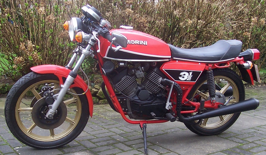

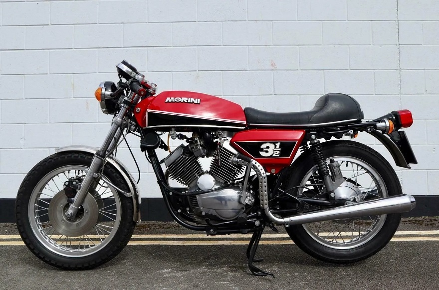

Well, you can go a certain amount of the way towards making a K Sport look like an earlier model but it will never be entirely convincing. The biggest giveaway is the frame. The early bikes have straight down tubes and the later ones kinked downtubes which means the front engine mounting plates are different.
Some parts may be a straight swap. Probably front mudguards, headlamp, indicators and instruments as long as you change everything including the mounting plates.
Early fuel tanks bolt on at the front whereas the K's slip over a spigot. The seats mount differently also, the early seats being held at the back by two threaded knobs similar to side panel knobs.
Talking of side panels, if you try to fit early ones to a K you would probably have to remove the tailpiece mounts in front of the shock mounts as they would look a bit odd. The late '70's pointy ones would probably fit straight on but with the early rounded type you would certainly need to remove the mount for the electric starter solenoid.
As the electric starter would be going, you could fit the early slimmer right hand side engine case, but you would first have to remove the steel ring on the alternator that the starter shoes grip onto. With the slimmer side case you may also need to change the footrests or fit rearsets.
I imagine that silencers are interchangeable. Not sure about the early/late exhaust heat shields. It is possible to swap from cast wheels to wire ones although finding the right hubs may prove difficult and expensive.

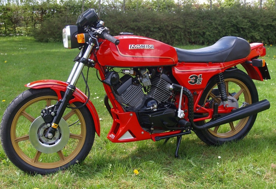

I have attached a couple of photos which show the obvious differences. The bike in the third photo appears to be some sort of an interim bike with parts of the old and the new. It has a kinked frame and later front mudguard and silencers, but also the earlier tank, seat and side panels. Moto Morini tended to produce bikes according to what parts/paint/ancillaries were available on the day. That is partly why you won't find any 'rivet counters' in our club.
So, in answer to your question, the answer would have to be no. Best to buy the bike you want and enjoy it.

I think photo 3 nailed it. The chap was saying his had front mudguard similar to mine, but the seat and rear mudguard differed, although his seat description was that of a original series model with the rounder seat hump.

Well, the rounded early Sport seat would certainly fit onto the bike in photo three. Maybe he had something of an interim bike?
