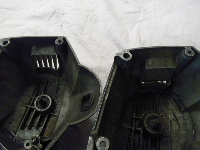

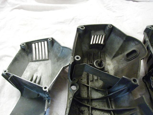

It allways depend on the specific condicions and circumstances what temerature the materials can endure. I´ve read somewhere that chloropren may resist till 100-120 °C, HNBR till 15o°C. Chloropren anyhow is not petrol resistent!!! For examole taking off float chambers may include the risk of weakening the belt structure.
Hartmut has made some testing of the temperature under the right hand cover. He didn´t measure higher temperarures than 87°C even with hot motor in town traffic. Anyhow there are some differences acording to the models of the covers. The first ones have had the best ventilation. Later esp. the front air inlet of the the Enduromodels sidecovers were partially closed (obviously to protect the alternator against mud and water) showing higher temperatures (even from this Enduro air inlets there are differnt models).
