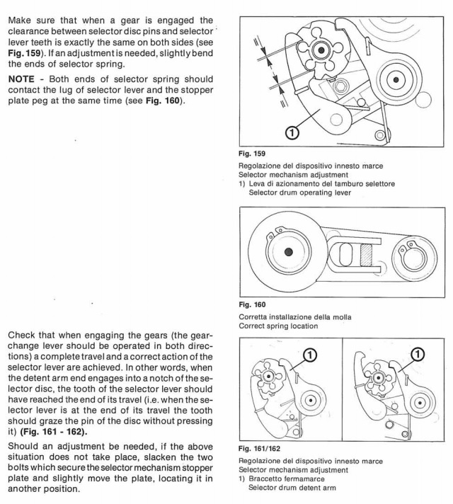

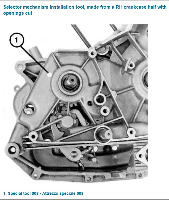

WARNING!
If/when you strip it, DO NOT remove the spring hook plate from the crankcases unless you have access to the special tool to realign it properly. If not correctly aligned, you might not get all the gears, or you might be able to change up but not down. Get it wrong and it does mean a full strip down to reset it. I have got the T-shirt for this!
The Cagiva era manual does have a lot more info on this item regarding alignment, but without the tool ( or an old cutaway case half) it can be very difficult to get right.

The special tool George referred to is Morini Special Tool 008. Attached are some images from 'The Blue Book' which can be downloaded from the Club Library if you are a member.
Changing the subject briefly... Obviously the gearbox issues are your priority, but if you are still looking for some top quality side panels, the ones I have for sale are the correct ones for your bike.
viewtopic.php?f=5&t=8068
Good luck.
Special tool 008.jpg (111.4 KiB) Viewed 197 times
Selector 01.jpg (139.94 KiB) Viewed 197 times
Selector 02.jpg (147.72 KiB) Viewed 197 times
