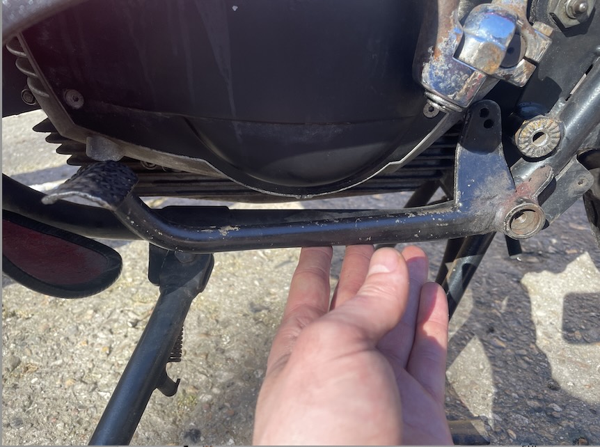

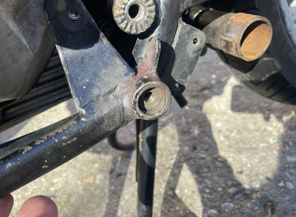

Hello Morini experts:)
Was wondering how the brake pedal would normally mount. Does this look normal?
Do I need a special bolt with a spacer, to fit the brake pedal.

Re: Brake pedal sport 77
I think it should be flush then held by a bolt and washer.
Post by GHF »
Mine has a flat washer and bolt.
Gordon
Post by RedVee »
Mines a '77 Strada and it's the same as Gordon's apart from the washer being shinier! :D

Does any of you know the depth of the mounting?
I got a brake pedal from a Strada. Wonder if it differs from the Sport model, other than being too long..
Post by GHF »
If this is the required measurement.
I measured mine at 27mm.
The bolt is M8x14 the washer M8x24 according to my parts list.
