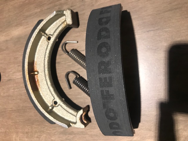

They do have C shape slots - the picture M&P use is representative only.

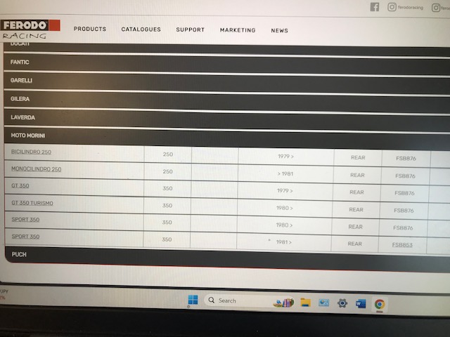

I attach a picture of the ones which were the wrong size I bought (160mm - Ferodo FSB876)
Also see Ferodo's fitment lists.
The smaller ones I've pictured fit many Morini wire wheeled models and they are for sale if anyone's interested!

Gareth, if you read my earlier link to M&P in Wales, the shoes they can supply are 180 x 35mm - the ones you require!
The brand is Ferodo FSB853 - see details here:
https://www.ferodoracing.com/ecat/code- ... oes/FSB853
The price on M&P's site is £48.61
