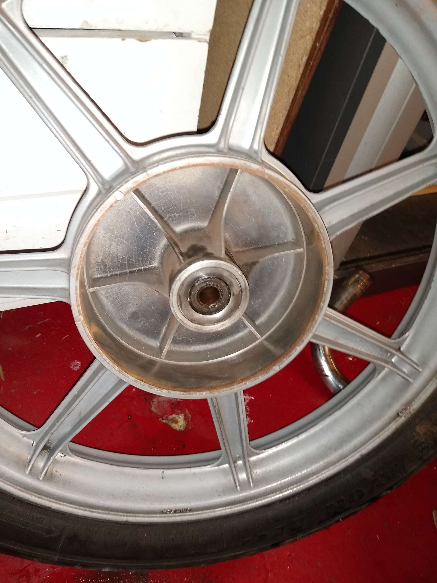

Re: Rear Brake Shoes
Fastmongrel
Posts: 208
Joined: 07 Nov 2022 22:37
Location: Lancashire
Post by Fastmongrel »
Fastmongrel wrote: 06 Nov 2023 10:40 Time to take my cast rear wheel out and measure the drum.
I can confirm it's a 180mm drum on my 81 Strada with cast wheels
1981 3 1/2 Strada
Is the shoe on the left delaminating?
