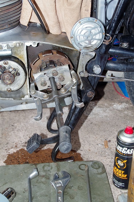

You can often get by with a standard screwdriver if the stud nuts have not been overtightened or have not been left undisturbed for years. I use a tool designed for BSA/Triumph clutches which works OK.
To hold the clutch 'hub' I use an old plain plate with a length of steel strip bolted to it. A universal clutch holder might also do the job. I have a Motion Pro one that also works on my 57 Gilera, but much cheaper ones are available.
I only have these tools because I was regularly swapping clutch stacks between bikes when hill climbing.

Going to get stuck in to stripping down one engine soon, so I will bear in mind it may need tweaking, though the trusty plate and strap are still in the 'special tools' drawer. At least you don't need a puller to get the hub off. Unlike the Gilera where I had to get inventive with a two leg puller and a piece of dural.
