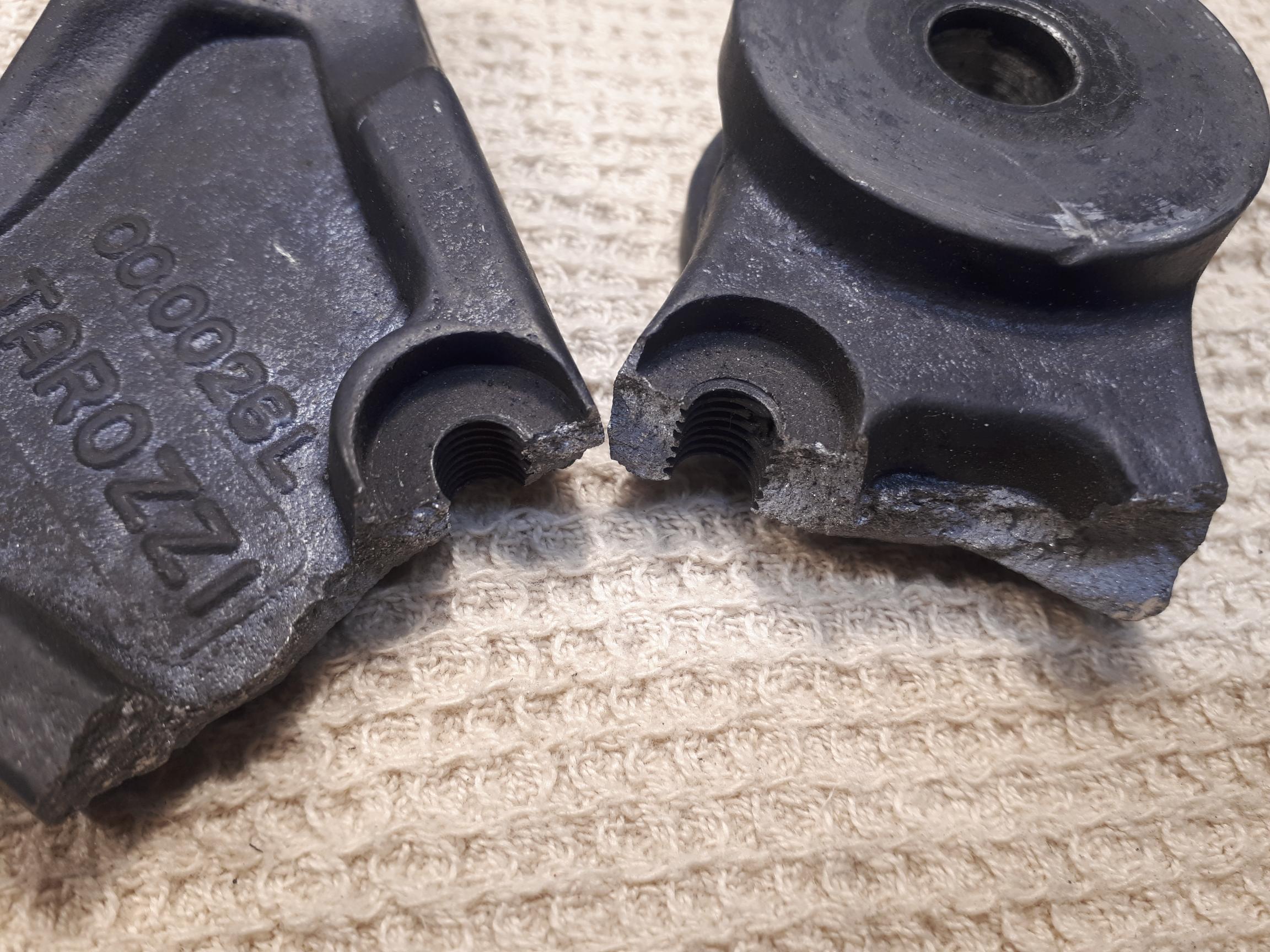

Afternoon all,
My 76 strada and I recently had the privilege of a very close encounter with a very very large dog resulting in a bent exhaust and a snapped left side Tarozzi rear set mount (part No 0000026). I looked on line and a seller near me said one could be ordered in 5-10 days, fair enough thinks I. Four weeks later and it appears that no parts are available in Italy, I contacted Tarozzi directly by e-mail and all are declared un-deliverable due to 'over-full inbox', they do not answer the phone either. All in all this is not good. All the usual suspects in UK seem to be in a similar situation.
I think my only option is to buy a complete set or repair. Is it possible to weld cast aluminium with and degree of strength? The break is quite clean.
I have asked on the parts forum if anybody has the part but I do not hold out much hope.

I suppose you could weld the break and then plate either side?

Definitely possible to weld them. Had a set done for mine years ago. Find a good welder though for obvious safety reasons.

I had to get a footrest welded quite a few years ago. It didn't go very well the footrest kept bending on the weld. I don't know anything about welding so can't say what went wrong maybe the metal got too hot.
Apparently I should have had it Tig welded not arc welded.

I dont think the plate option will work as the break is close to the foot peg mount, I may not get any purchase. I will try and find a specialist MIG/TIG welder close-by. It is very difficult as nobody out here in the sticks is on the internet, its word of mouth only. I am toying with gluing the broken bit, getting it CAD scanned and then CNC milling it from billet alloy. I fear the cost may be out of my reach but it is a possibility.
The latest info from Tarozzi is that they are working on a 'collaboration with a major manufacturer' and have had to suspend all other work (including answering the phone/e-mails apparently). Normal service should resume by the end of May.
