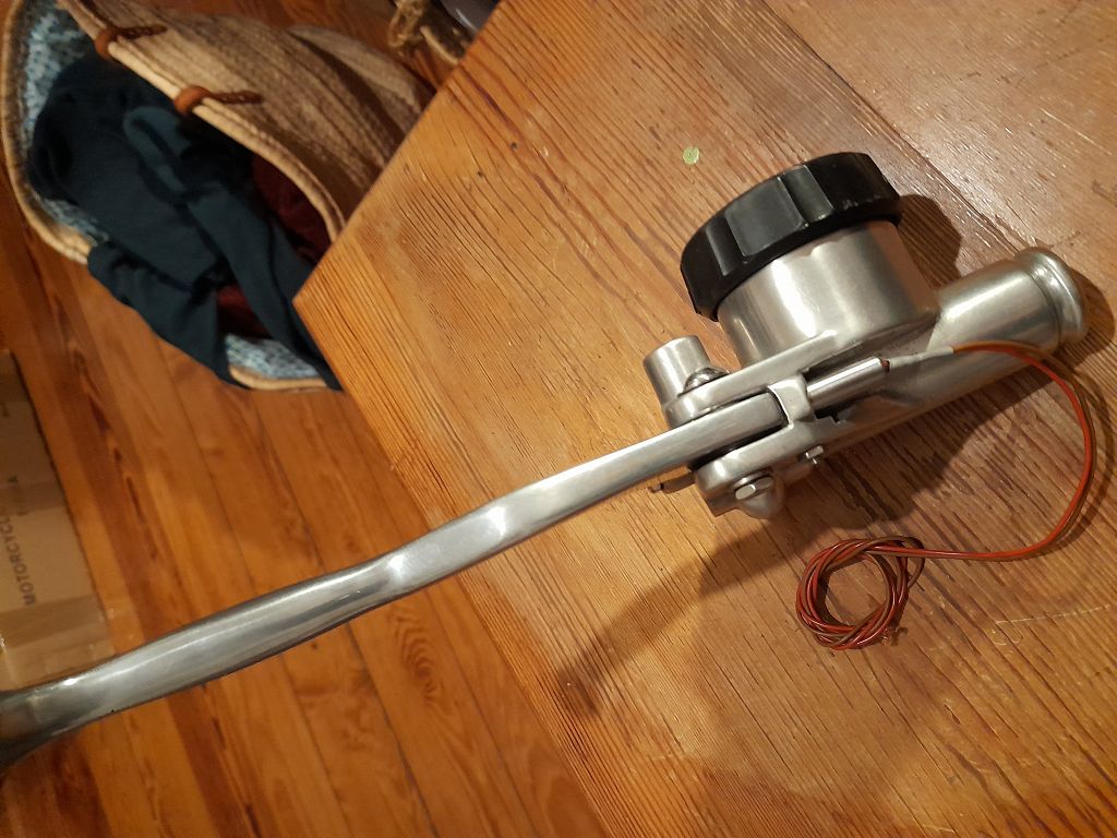

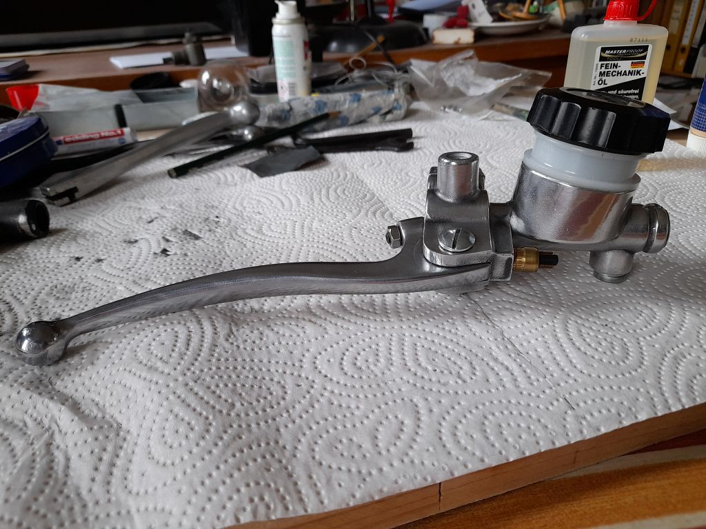

This is a 16mm (error: it´s a 13 mm!!!) mc that was destinated for my 500 Frankensteinproject. Before I used it with my 350K and it had a thread for the switch. Of course in that times it was not that shiny :wink:
A friend of mine, who will do the electronics on the bike, drilled the thread to 8mm so he could import an 8 mm aluminium tube in which he glued a Reed-Switch (with a very small magnet in the lever). Underneath there is a grub screw to adjust the switch (distance switch-magnet).
Posts: 841
Re: Twin Disc Master Cylinder
Oh sorry :oops: the first foto is a 13mm mc for clipons. But I will not use it with the dobledisc of the 500. It´s the same I´ve mounted on Rocinante with double disc (that one with a certain danger when panic breaking).
But the 16mm mc of the second foto, that I used before mounting the 13 mm one, also had the thread for the switch.
