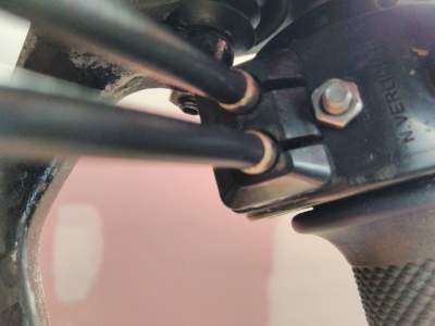

Sorry, Ben, I forgot.
Photo attached.
As per G&T, but I put the bolt inside the throttle and the nut outside...
