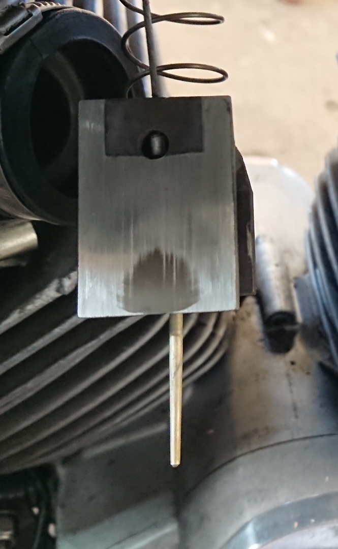

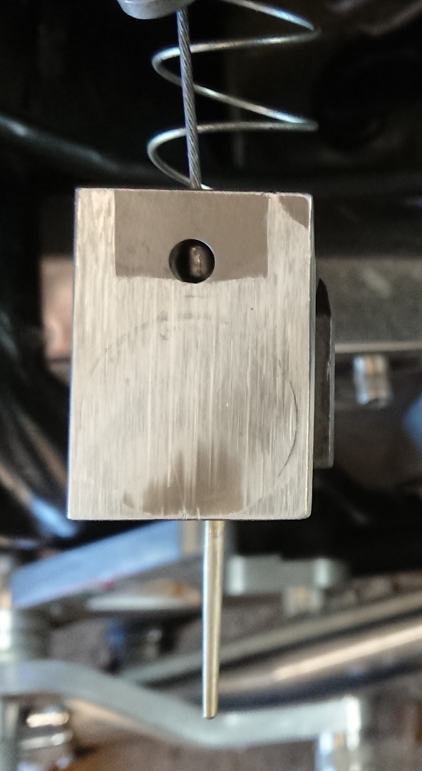

Please forgive the quality of the image but these are the current state of the slides in my carbs.
Front Cylinder slide
Rear Cylinder slide
The needles do feel firm enough in their position.

Thank you for the pictures.
Not quite the worst I have seen but very bad.
These are most likely worn out. Even the venturi area anodising is missing.
Place the slides on a flat surface and see how much feeler gauge
you can get under the edges towards the top of the slide which will be more worn,
you can see where the anodising remains at the top, if you can get 0.07mm or more then they are worn out.
If you can feel a step then they are worn out.
I would also say that the needle is worn by contact with the atomiser, see how it is shiny on the engine side but clearly stops
at the point where the needle is above the atomiser. There is also a pitted ring of corrosion at the top of the
worn area. I would replace the needles and atomisers too.
There is no guarantee that new slides will fix the issue
if there is wear in the carb body or other problems.
This kind of wear is caused by unsupported carbs with non standard air filters,
or after very high mileage.
Paul asked about whether the carbs were properly clamped in a previous post.

Carb : VHBZ 25BS
Choke : 50
Idle : 45
Atomiser : 260k
MainJet : 115
Slide 7447.50 (NEW)
Needle Type : E17 (NEW)
Once I had balanced the carbs and set the idle the 1st big difference was the bike would idle without tumbling into a stall after 30 seconds. This has always been an issue with my bike and was one of the biggest barriers to enjoying riding it. Having the bike simply drop revs and stop at a set of traffic lights gets very old very quickly.
I took the bike for a decent 1st run, 30 minutes of hard riding and back home to waiting balancer. I then again balanced the carbs, adjusted the cables, set the mixture and set the idle in the normal roundabout method. After 15 minutes of this I was able to get the bike to idle at 1400rpm(ish) which again was never possible. That ended Saturdays work. On Sunday I decided to go for a good run to the coast and stretch the Morini's legs. Idle stayed reliable and I even stopped worrying about blipping the throttle at every junction. As I got closer to the coast the air got a lot colder and I noticed that I was down on power or more a feeling of having no real torque. I also noticed that if I cracked the throttle open hard while idling, the bike would stall. My conclusion is that the idle jet of 45 is now too small and I should go up to 46 or maybe 48 again, most likely the slides have had the biggest impact on reliability and actually I don't need such a small idle jet anymore.
Could I ask the more knowledgeable owners (I am looking at you Mark and Paul) for their thoughts on my findings?
Lastly I am making a plea for someone to please sell me a pair of 260BD Atomisers if at all possible. I am not able to find them anywhere and I think they would also be a good addition to my rebuild.
Thank you.
