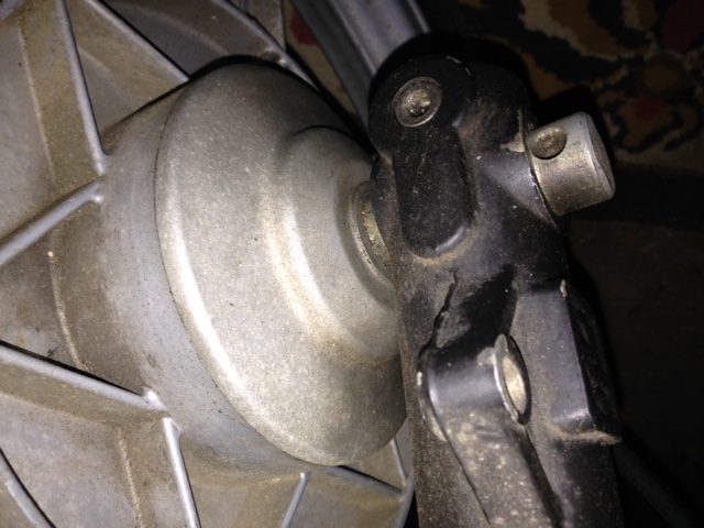

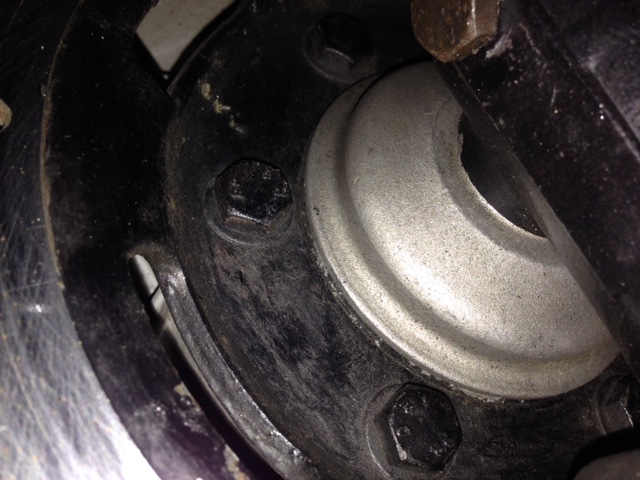

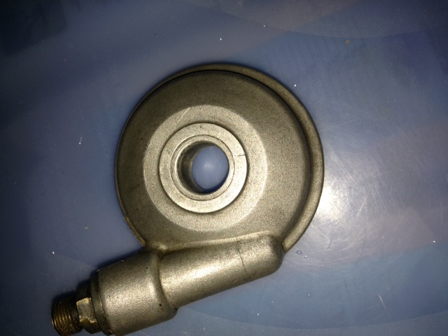

I find a single disc perfectly adequate, especially with a smaller diameter M/C setup. The splitter can be blanked off or replaced with a single brake line. The hydraulic switch may be moveable to the M/C if there is room. The 'problem' is that the diameter of the speedo drives for single and twin disc set ups is different, so a double speedo drive does not look so neat on a single disc.
This is a spare
Double disc.JPG (89.25 KiB) Viewed 6514 times
Larger diameter unit for single disc - disc attachment drillings in hub masked.
Single disc.JPG (108.94 KiB) Viewed 6514 times
Double disc bike - the speedo drive does not cover the disc attachment.
D Disc + bolts.JPG (117.09 KiB) Viewed 6514 times

Thanks Ming, that’s very clear.
