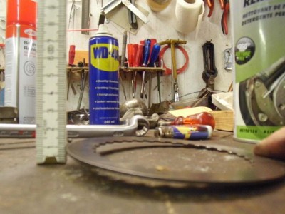

This is the most convex I´ve found, supose that it is nearly original :wink:
Posts: 1559
Re: How convex is "convex"? (Clutch plate)
If that's what they are supposed to be like I'd better order a new one!

The new convex plate supplied by Mdina is indeed much more 'dished' than the old one. Now re-assembled with that and the other plain plates which have been first given a blast with the orbital sander. I remembered that I had to use a full plate rather than a half plate to stop it slipping (even with all new plates). The spring cups looked OK and the length measured as the same as on the other unit (though that uses assist washers anyway).
Too early to be certain but a much more progressive action now just creeping it on the drive. I shall know more after a proper ride.

The conical plate should be pretty much the same height as the plain ones.

EVguru wrote:The conical plate should be pretty much the same height as the plain ones.
I was comparing how much it rocked on a flat surface. The old one was pretty pitted too to be fair.

I was refering to the height of the plate on a flat surface, rather than its thickness.
Posts: 1559
EVguru wrote:I was refering to the height of the plate on a flat surface, rather than its thickness.
OK. I didn't get round to that, but I suppose it must certainly be 'higher' than the old one. The comparison with the other plain plates would be a useful diagnostic if you haven't got a new convex one to make a comparison with. I'm hoping not to have it apart again though!
