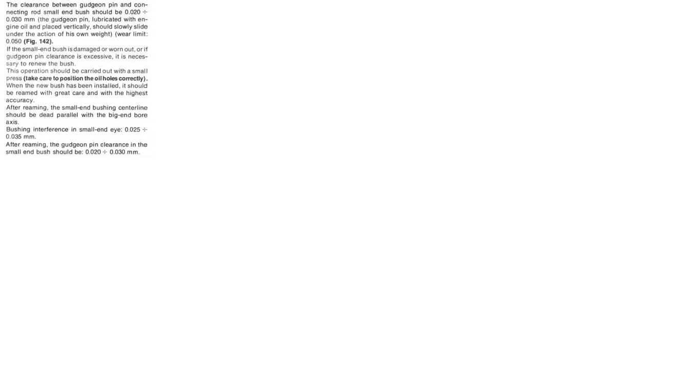

The service manual says:
Gudgeon pin.jpg (66.33 KiB) Viewed 3738 times
