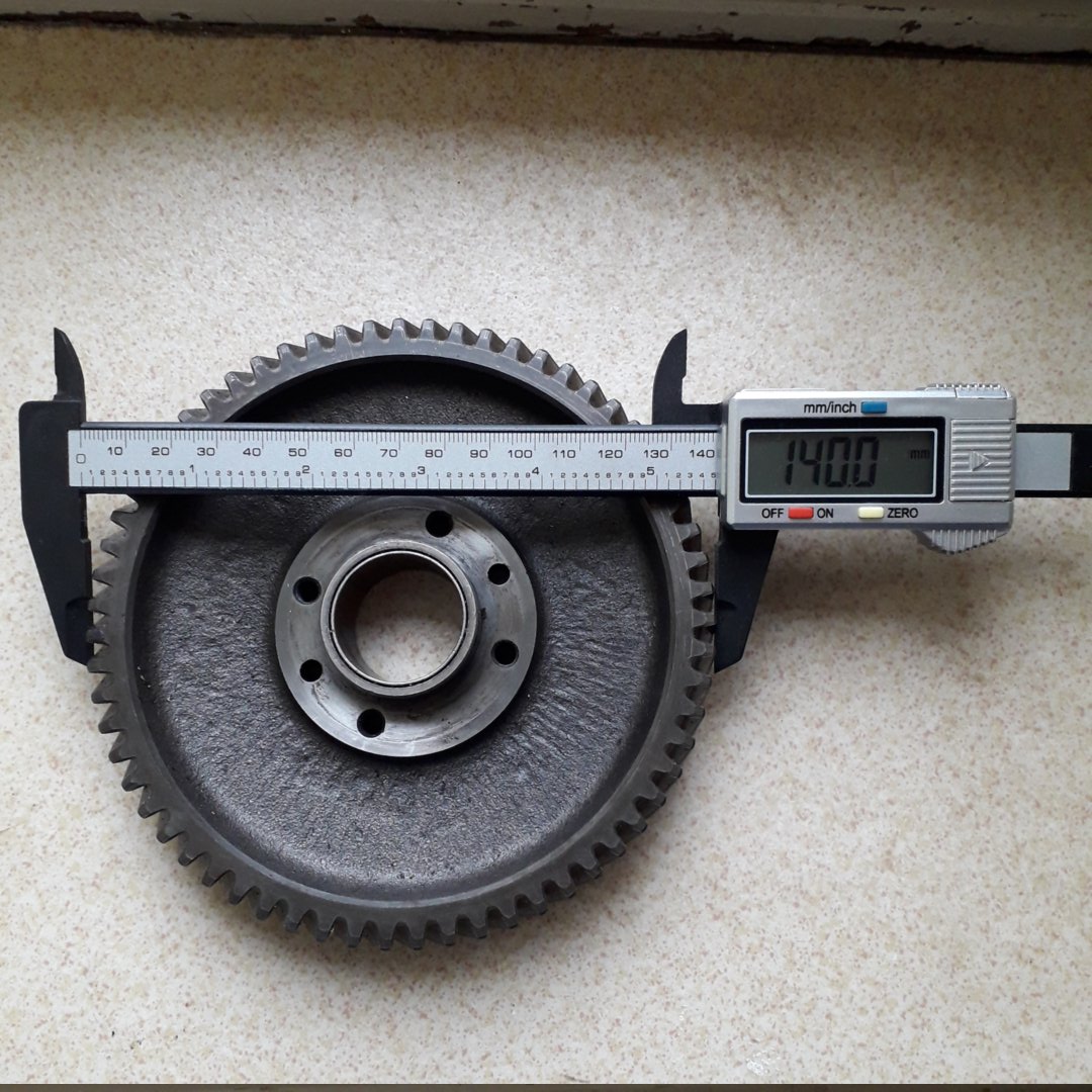

I think I have a 501 Excalibur primary gear somewhere. I'll dig it out and count the teeth (must get out more).
Re: 500 transmission Question ?
Finally got round to it:
No obvious wear, no damage.
Just re-read previous posts and seems it's a common unit, so probably no use to you!
